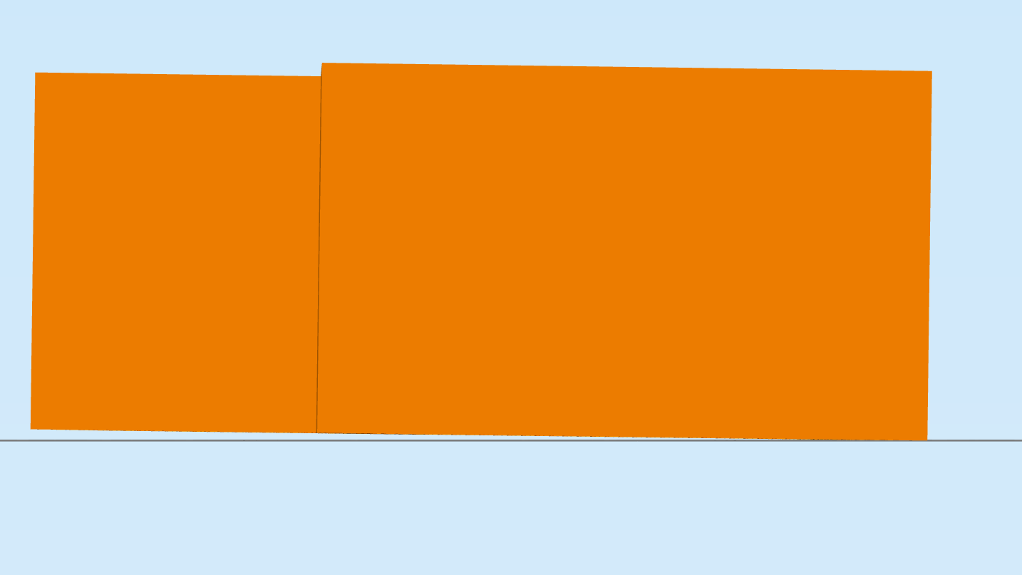

Your shapes may be flat on the bottom, flat on the top, and have the top and bottom parallel....but if they're not placed flat on the bed, they're not going to slice how you want then to slice!
S3D does not have a slicing bug!
Re: S3D slicing error, outter shells not properly working
yes your model is rotated and not flat on the bed. here is a side view.
Konky
Posts: 33
Joined: Thu Feb 18, 2016 9:08 pm
oh my!
Thanks for solving the mystery
