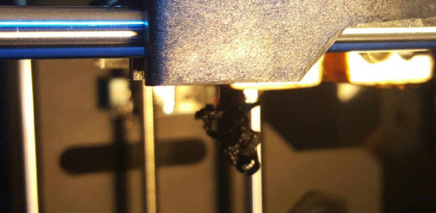

Hi I am new to Simplify 3D and filament extrusion printers. I recently bought a monoprice dual head extruder printer. I swapped out the nozzle it came with, with a .2mm one from Micro Swiss. My coworker has the exact same setup and he is having great results. He setup a test print for me to try. It was just a simple cube. It printed my first try perfectly. Then I added a mesh to the same file and deleted the cube so I could use the same settings. I had Simplify 3D generate supports and infill. When this print started it separated from the build plate after a few layers. I stopped the print. I tried to print the cube again just to make sure I didn't change anything. It didn't print. I eventually realized the nozzle was clogged. I had to take apart the head and pull out the stuck filament. I reassembled it.
Tried to print the cube again, but now the filament curls around the nozzle. It doesn't stick to the build plate. It just forms a big blob of plastic on the nozzle. When the printer is getting ready to print it lays down a line of plastic at the front of the plate to clean or prepare. That line always goes down more or less fine. I say more or less because sometimes it isn't perfect but it does lay it down. That line doesn't blob up on the nozzle.
Had the printer never worked I would just assume something is very wrong and maybe return it. But it printed perfect the first time. And my coworker has had none of these issues. I can upload video, photos or whatever else is needed to help find the problem. Thanks,
I am printing in PLA and most of the settings were done by my coworker which I think start from the monoprice settings simplify 3d comes with.

Blob on nozzle
Blob on nozzle

Raise the nozzle 50-70mm off the bed and extrude 5mm of filament. Does it curl up? It should extrude directly down onto the bed with little to no curling.
If it does curl, the nozzle may still be partially clogged or the exterior may be dirty. Given the low bed temp, I'm assuming you're using PLA. SCIGRIP 4 solvent is known to dissolve PLA... like Acetone dissolves ABS. Disassemble and soak the nozzle overnight.
As a final (optional) measure, thread a strand of wire through the nozzle to ensure its clear... .2 is very fine. Maybe a few strands from multistranded connecting wire will work. But may not be stiff enough to clear any blockages. Do no stick a solid object like pin tip in the nozzle... it could damage it.
Hope that helps.

Ok I figured out how to get the printer to just extrude filament using Simplify3D. It must still be clogged because the filament does still curl. I even tried heating the nozzle more than needed from 210 to 240 and it still was curling. I ordered that solvent. Any ideas where I could get a firm enough wire to push through a .2 mm nozzle hole? Thanks again for the help.

They make nozle cleaning drill bits that are handy for clearing out the tips.
You have to be super careful with the small diameter tips because they seem to be easy to damage. Bed leveling is critical to good prints with such a small tip and layer height.
I almost always print at at least 0.1mm thickness or more for the first layer.
