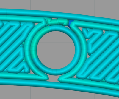

See picture below. (Sorry about the quality but the issue is still visible.)
The part is 6 mm and the hole is Ø3 mm which means there is 1.5 mm on each side of the hole that should be filled. Seems like it shouldn't be a problem but apparently it is. Extrusion width is 0.5 mm.
I'm guessing there should be a simple way to solve this issue but I haven't found it.
This part is not the first one I've had the same issue with. Holes being printed "stupidly", leaving gaps. Come to think of it, I have a photo of a different part with much bigger holes showing the same problem towards the part perimeter. See picture:

It looks like you need to increase your "outline overlap" setting on the Infill tab. That will decrease the gaps between the infill and your outlines. For example, if it's currently at 10%, increase it to 30% or something like that.

It's not really the infills though, it's the top (and bottom) layers. So I think more infill overlap wouldn't help. Also, it's already at 25% if I recall correctly (currently at work so can't check).

That setting DOES affect the top and bottom solid layers. Trust me. Increasing it to 40% will most definitely improve the tiny gaps you have there.

I've made a little experiment and can confirm your tip about increasing the overlap. However, this seems like a stupid workaround for a problem based in poor "pathfinding" in the software.
Below are screenshots of the printing preview using different values for infill overlap, from 10% up to 90%. Setting it to 90% as opposed to 10% requires about 11.5 meters of filament for this print instead of 10.5, so that's about 10% extra material, for filling in a few really tiny gaps. 50% probably is enough but still seems like a waste to me.
With Mattercontrol (Matterslicer) this same object is printed without the gaps using only 12% infill overlap.

Adding overlap is one of the last things that I change when I have this problem.
What you want is to force the thickness of the wall to be a multiple of the extrusion width. Assuming you have a 0.4mm tip try reducing the extrusion width slightly until the issue goes away. I've also had luck increasing the width in some cases. This will not increase the amount of filament used for the print.
Increased overlap basically forces over extrusion at the ends of the tool paths. A small amount won't matter but a large change will have that over extruded look especially for smaller parts.

i agree, as you can see if you have a 1.5mm space, the hole and outer perimeter wall account for 1mm of it. you can see that the second perimeter will add 2mm which wont fit. you need to either set your perimeters to 1 wall OR lower your extrusion width down narrow enough for 4 extrusions to fit your 1.5mm space. you shouldnt lower the width lower than your nozzle dia so if you still cant get it with that then you can start bumping up the overlap.
