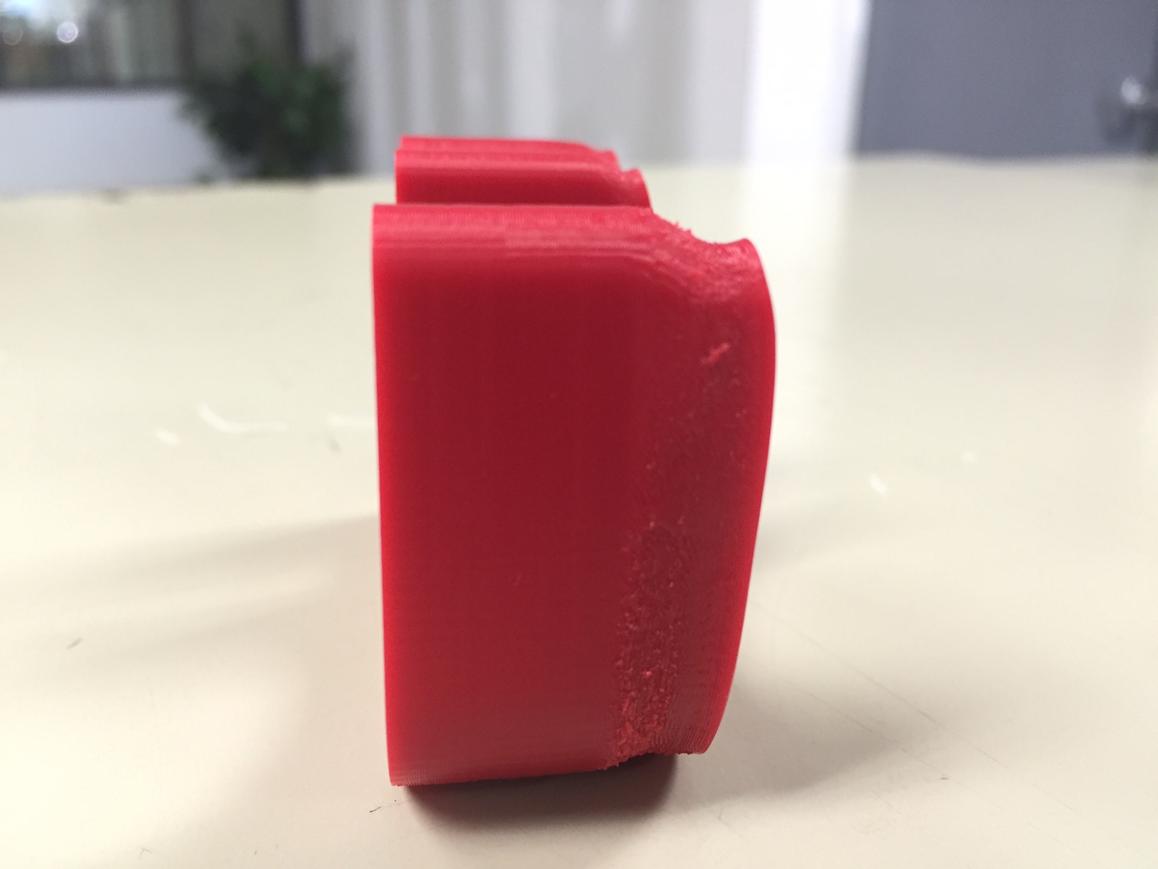

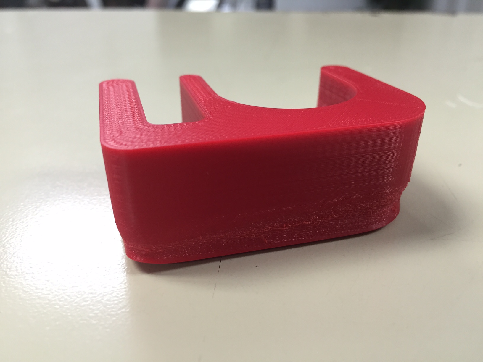

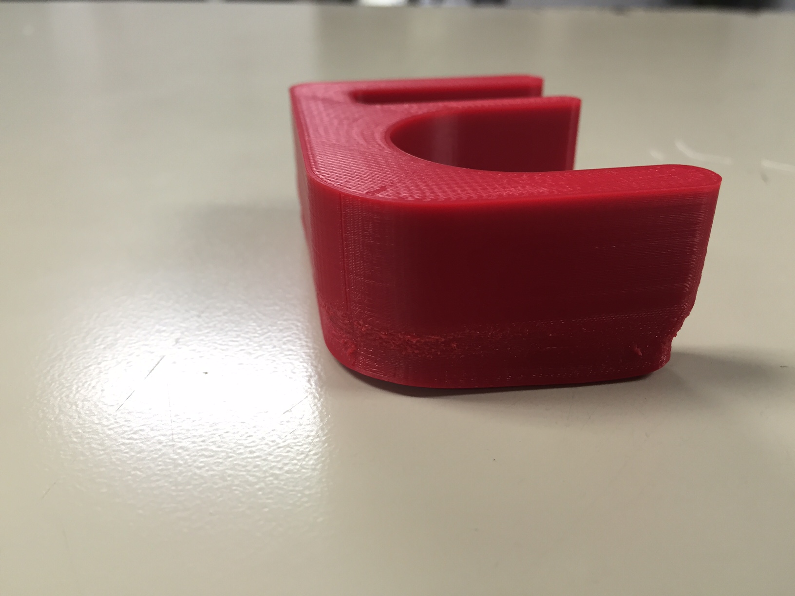

Trying to get a part printed out at work, we're using Hatchbox ABS Filament. I'm using AquaNet Extra Super Hold, with a bed temperature of 110C and a nozzle temperature of 235C. The part with a large-ish base continue to lift during printing and as shown below, the bottom layers look like they had some issues. It's not like the part was overly huge or anything.
Is the ambient temperature too cool? It's usually 17C to 20C. Is building an enclosure to maintain an ambient of 100F (approximately 38C) a good idea?
What other information would be helpful in tracking down issues? I consulted the 3D troubleshooting guide, but would like more input.
