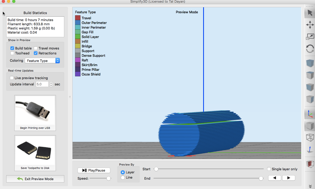

I am trying to print a simple cylinder but Simplify3D misses one layer in the slicing (see picture) which prints two disconnected parts. The model passes all the mesh tests in Simplify3D and when I try to separate it into connected surfaces it stays as a single model. This is weird. I sliced many parts with Simplify3D and never had a similar problem.
Another wired thing is that if I raise the object along the Z axis by 0.01mm the problem disappears. (the object is well placed on the Simplify3D bed, using the drop model command).
It's not just a missing layer because Simplify3D actually slices them as two individual models, with the bottom one having top shell and the top one having bottom shell.
I am using version 3.0.2 on Mac OSX 10.11.14 (Macbook Air 11").
