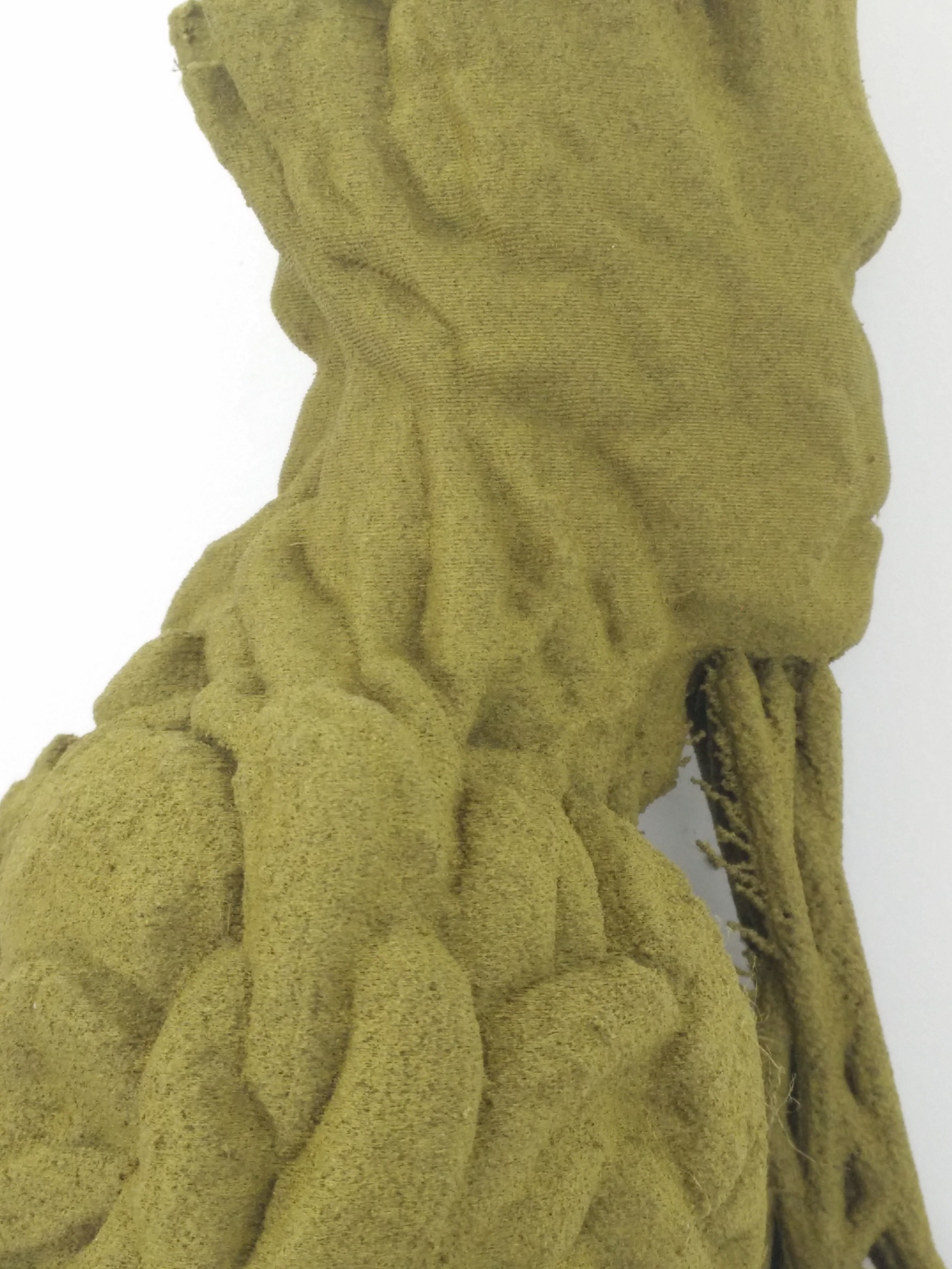

I have a good example print here that shows the problems this gives.
I chose a .1mm layer height which gave a really nice result on the bottom and top part of the print. The layer are nearly not visible.
The middle section of the print (his face) had the shortest layer times because it's the smallest. (Which activates the speed overrides code)
This resulted in very visible layer lines in those areas, as the repeating layer pattern now happens every 2 layers instead of one, so it looks as bad as if it was printed on .2mm resolution.
