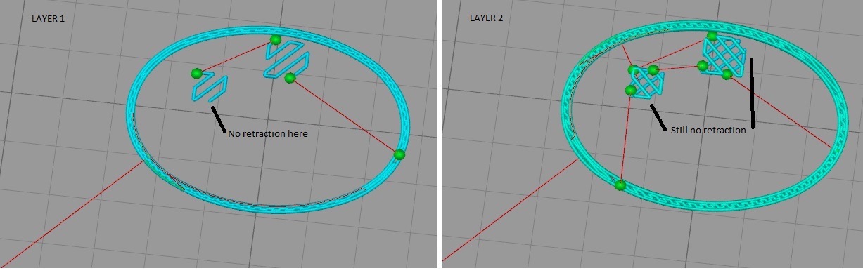

Sadly the bug still there in V3.1.1

I just noticed I have a bunch of strings coming from a support. Watching the gear during retraction, it does nothing at the end of the support. I have support every other layer, and this is the only support. I noticed on detailed figures with lots of supports that I was getting strings as well. Calibration tests printed fine (no supports), and figures without supports printed fine, so I thought I was going crazy. Hopefully this bug gets squashed soon.

Your factory file works fine for me in the latest 4.0.1 version. When I load it there is clearly a retraction when it moves to each process, and then it does a wiping retraction right before leaving the process. So it appears to work fine in the current version.
Try re-downloading the latest installer from their website and if you're still having trouble, post a screenshot and mention the exact line number where you are seeing the issue.
