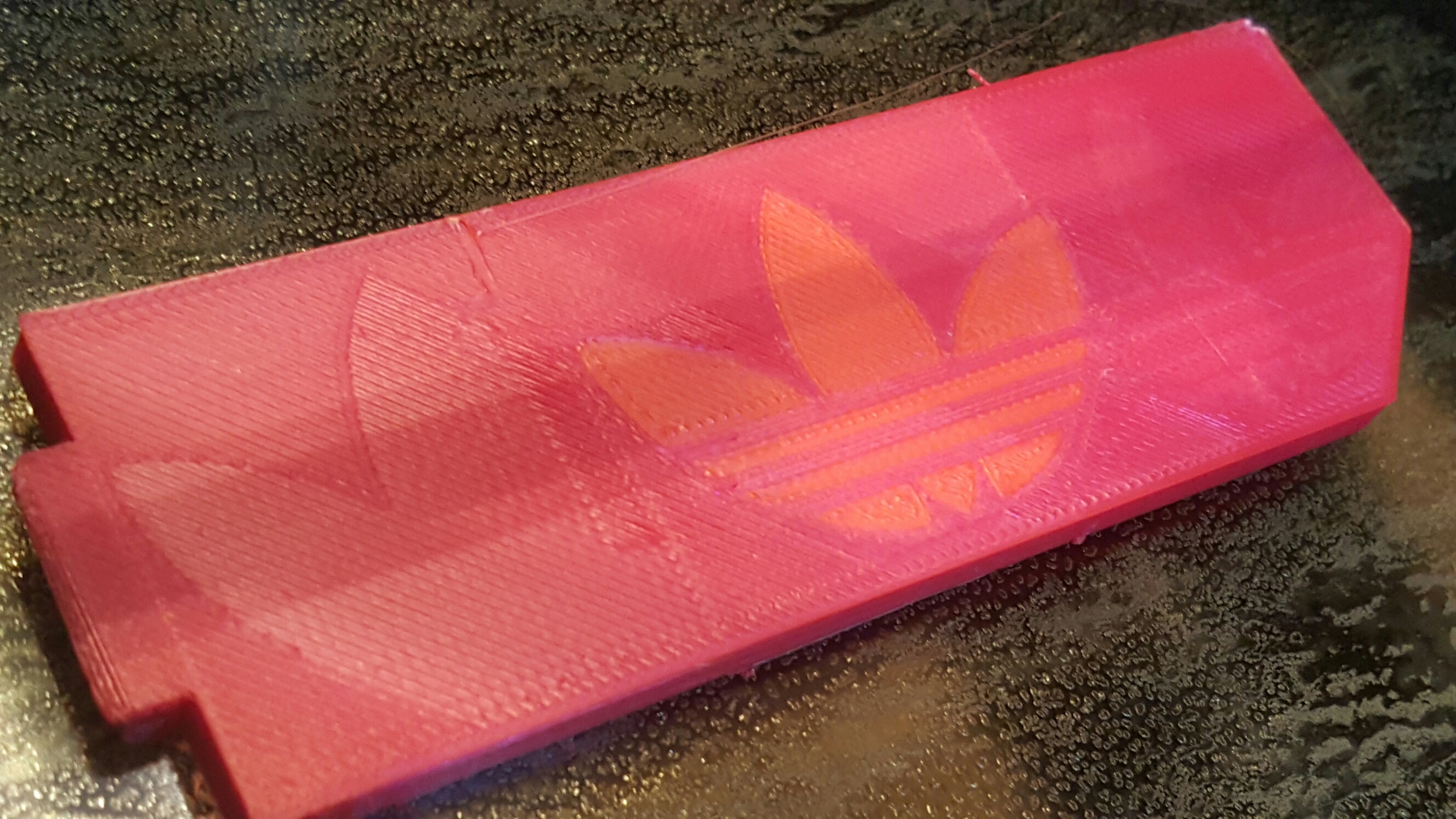

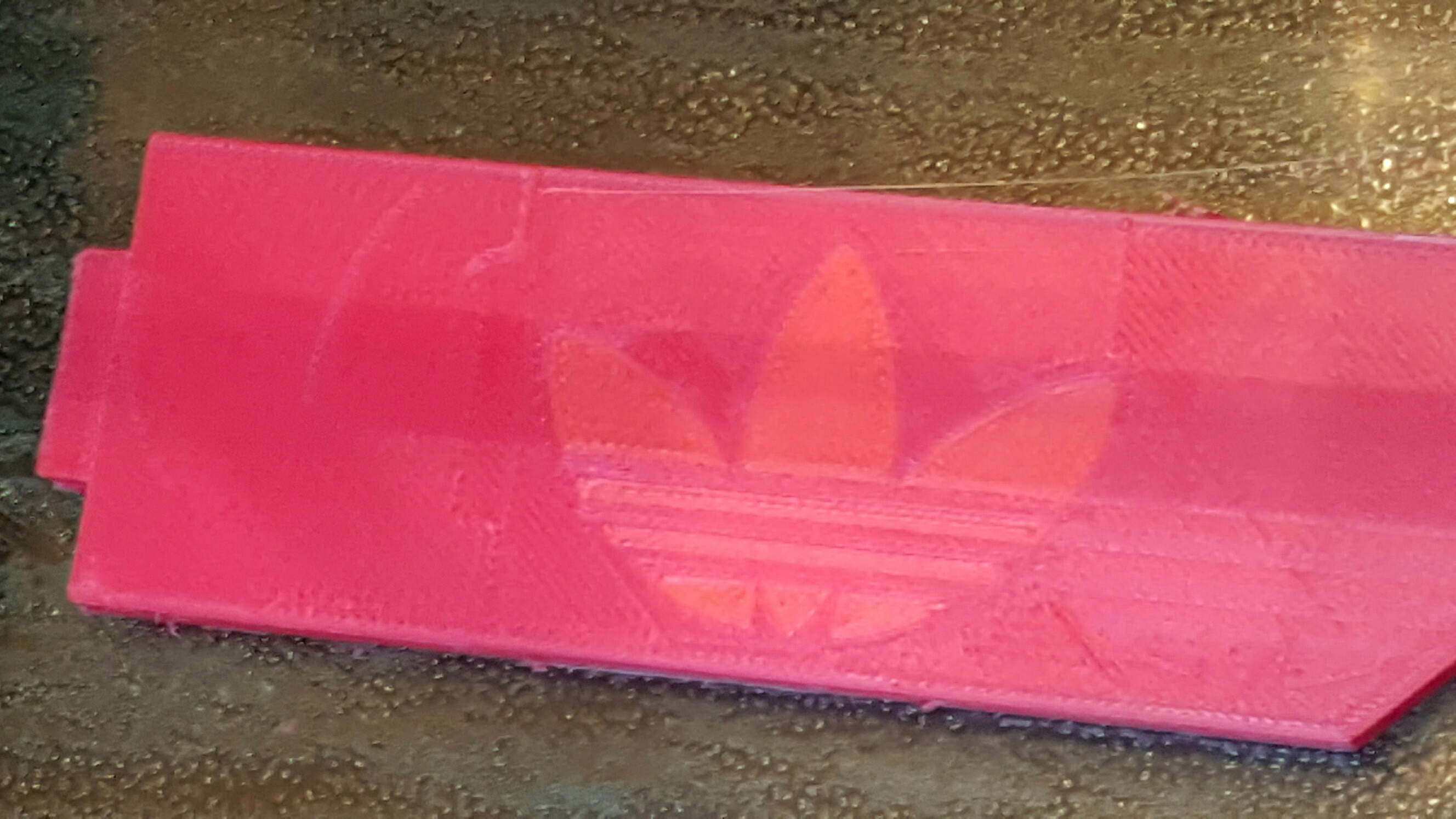

Made a cover with an Adidas logo. Getting ghosting of the Adidas logo on either side of center.
See attached.
Main is red with Orange logo. The ghosting is in red by the way.

Now looking more at the pics...looks like the nozzles are not level. Which i assume is the biggest problem with dual printing. Any suggestions short of loosening one of them until flush with the other. As leveling would not play a factor here.

That link may be applicable....as the "ghosting" is on a dual head printer, and what the issue is that whilst one head is printing, the other head is being moved over the surface of the model and with it being hot and drippy, it's affecting the surface of the layer....giving the ghosting effect.
The thread suggests that the two heads are not correctly aligned vertically and that the non-printing head is a tiny bit low, resulting in it touching the top layer of the model whilst the other extruder is printing.

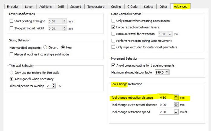

Agreed...and will make adjustment tonight. is there a function that allows for back feed of material once said layer is completed or it switches to printing on other extruder? This would allow the stop of any dripping onto other layers.

Just found this feature!!!
Ok, so my settings are (not attached image...thats from another member):
Only retract when in open spaces; yes
retraction distance: 12.00mm
extra restart: -.50mm
tool change retraction speed 600.00mm
