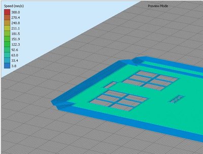

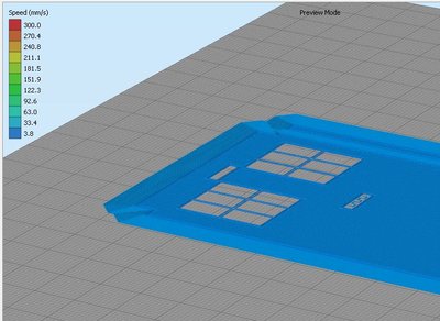

Your factory file - unaltered:
Layer1:
Print speed - 3.8 mm/s - skirt and first layer infill prints slowly!
Layer2:
Print speed - approx. 63 mm/s - second layer perimeter prints a little faster, infill prints a lot faster.
Looks as if it works to me!
