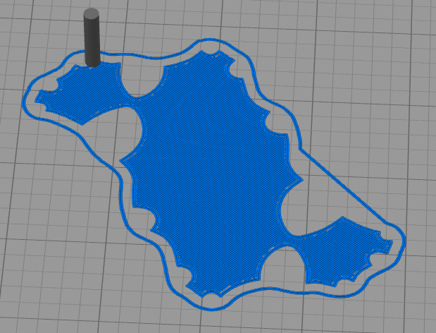

Here's layer 3-4:

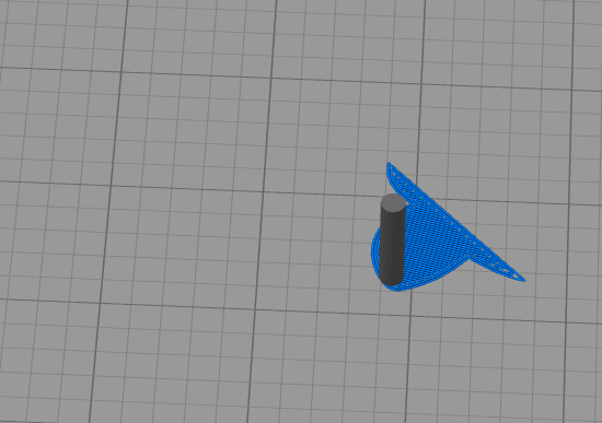

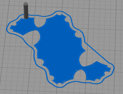

And here's what should be the next layer:

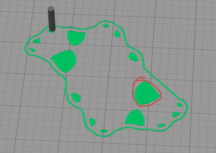

But this is being placed in between, at the same Z height:
This creates a web of material outside the model and squishes extra plastic into the same space as plastic extruded by the other nozzle (circled in red).
Any idea what might be going on here? Is this just a defect in the slicer?
