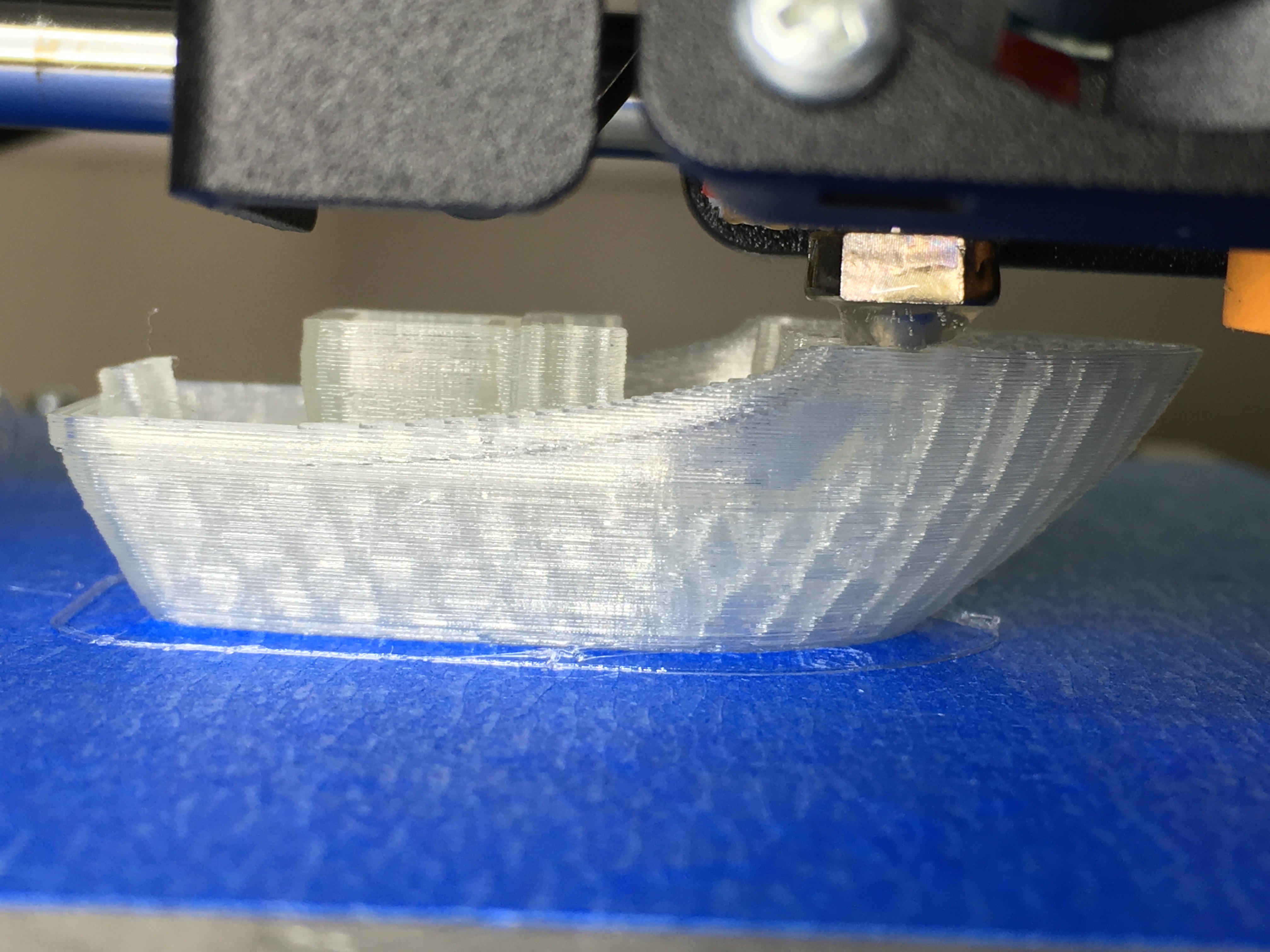

by wherefore
I just hit this as well. Running 10.11.5 (13F54) :
MacBook Pro (Retina, 15-inch, Mid 2015)
2.8 GHz Intel Core i7
16 GB 1600 MHz DDR3
Poor, poor Benchy. It was turning out to be a pretty good print, too.
Sad Benchy :(
Sad Benchy :(
