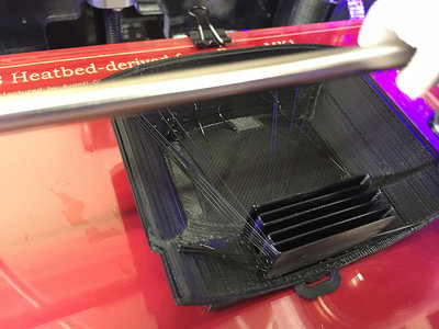

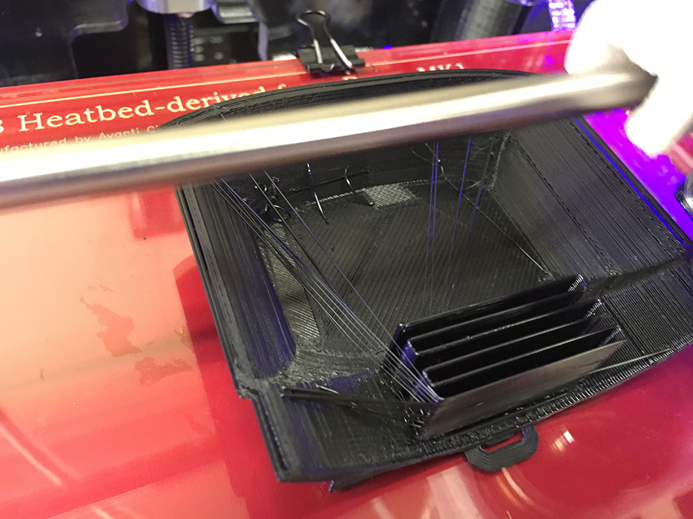

I have a print that travels a bit to get to a support, lay out that support and then go back to the inner wall of the print. I have s3d set to always retract when crossing open spaces. It does this on the way to the support but will not retract when returning to the print which is leading to missing filament by the time the print head crosses to open space to continue with the part. All the strings in the picture are coming from the support due to no retraction. Is this a bug or am I missing something?

No I hadn't seen that, it didn't come up in my search for an answer, I will give that a try, thanks so much. It sounds like it is a bug that hasn't been squashed yet. Thanks
Re: No retraction after support
You should try the new 3.1.0 version. They mentioned a few things about better retraction control, so this may have been fixed now.
