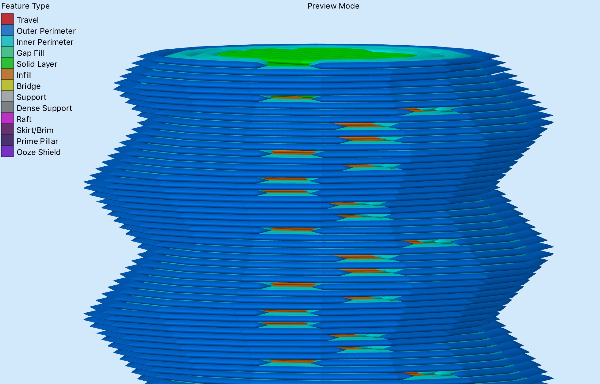

I'm trying to print a simple screw, in preview mode I see some little holes in layers like this image:
There seem to be no problems with the model, can you please tell me if may it be just a preview anomaly?

That just the coasting. If you turn off coasting it will go away. That's the point of the feature though. It stops extruding a bit before the end of the loop to help reduce blobs
