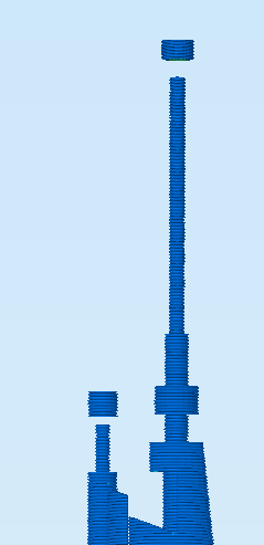

Hello
I have a strange problem !!
It missing some layers.
It's the first time that it happens
I have already spent it on https://netfabb.azurewebsites.net/
Any Idéa ?
A big thanks

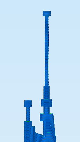

I have tried with "Merge all oultines into a single solid layer" and it's ok !!
But i lost the holes at the end of the canonn

Wall thickness is your problem.
The wall thickness of the barrel in the area where it misses out the layers is below the width of a single extrusion. You'll need to reduce the diameter of the tapered bore at the end of the barrel so the wall thickness is increased.
