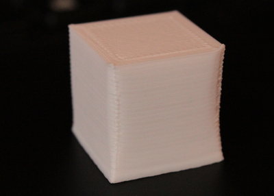

I am trying to print a rather detailed model of bones in ABS on a Flashforge Creator Pro, using Simplify3D v 3.1.0.
As the print progresses, the edges curl dramatically. Eventually the print head catches these edges, ripping components from their supports. This typically occurs within the first 11% of the print. (I have not bothered to determine the exact layer(s) at which the components catch.) The edges are not curling on the heated bed; indeed they stick rather nicely.
I have read the quick start guide and the Print Quality Troubleshooting Guide.
I have considered that the ABS may be cooling too quickly, causing the edges to curl before the next layer can be deposited. To that end, I printed several test cubes at different temperatures around 230º in 5º increments. I see no discernible difference in the output. The result is always a wide base with sides that narrow toward the middle and widen at the top. The corners curl up, giving edge lines a rounded appearance.
Test Cube
Test Cube
I also considered that the acceleration setting on the printer may be to blame. I turned off acceleration and printed another test cube. The speed was clearly more consistent, but the end product was no different.
Am I right in thinking that the problem here is due to the ABS cooling too quickly? Whether yes or no, does anyone have suggestions for how I might solve this?

I would actually say the opposite. I think you need MORE cooling. If it doesn't cool fast enough, it can curl and deform before it finally solidifies. So I think more cooling would help those perimeters stay put.

I've seen the same problem with ABS and solved it. Can't remember exactly everything I did though. A couple of points.
Are you using a cooling fan, if so don't at all.
Are you holding the 230 temperature for all layers, this should not change.
Lastly slow your printer down, your assumption of turning the corner into a rounded corner due to printing to fast could be correct.

The idea of increasing cooling had not occurred to me. Does the rate of cooling influence the amount of warping?
Regarding the suggestion of a heated enclosure: this is my next step. The ambient room temperature is cool (below 21c/70f). I'm in a basement and have little control over the temperature. I could move the printer to an egress window well, where the temperature will approach 26c/80f.
I switched to PLA briefly (with appropriate adjustments to temperatures & cooling) but it was a disaster. Perhaps I got a bad batch (Hatchbox), but 50-100% of my prints jammed. The filament felt uneven to the touch.
(FWIW: I have successfully printed this model in both ABS and PLA in the past using Makerbot Desktop. I've had no successful prints since reverting to ABS or subsequently switching to Simplify3D.)

Can you describe the print bed? Glass, tape, ABS juice...
ABS typically does not like cooling. Start with the fan off. Many people leave the fan off, but a little cooling (60% max) 3-5mm into the print will help... it's really dependent on your extrusion temp. A slightly higher temp will help layer to layer bonding reducing the chance of delamination on tall prints. The higher temp could cause problems with maintaining shape (ie screw holes).
Heating the bed to a higher temp may help the ABS adhere to the bed better.
A brim (5-10mm) will help "seal" the edges so cooler air doesn't seep under the print.
Try a little negative Z-offset to enhance the "squash" of the initial layer. Use increments of -.1, too much and the base of prints may be slighlty wider then designed.
I'd recommend a PEI sheet for PLA and ABS. At a bed temp of 100C, ABS sticks great. Buildtak and Printinz also makes products to enhance ABS adhesion to bed.
