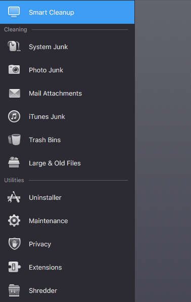

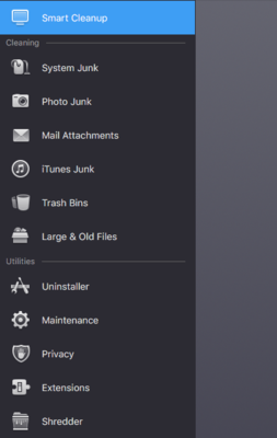

The last two are not difficult if you know how to work with OSX. However, I recommend the app "Clean My Mac" http://macpaw.com/cleanmymac because it has other very useful features, esp if you're not a fan of Terminal commands...
Three useful features of interest to you are the "Smart Cleanup", "Uninstaller" and "Maintenance".
Also, I've not used it but, inside an S3D folder along with the app, is an "Uninstaller"
Uninstaller
Uninstaller
Screen Shot 2016-06-11 at 5.20.56 PM.png (16.7 KiB) Viewed 4870 times
