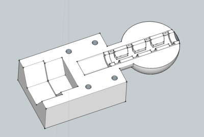

Hello Community!
I am printing a part which is supposed to be open to expose the inside notches, but the software is filling in my part :x . The face is not closed, so I'm not sure why this is happening. Can someone please let me know what I can do to solve this issue? Im a newbie and still figuring it all out.

Are you using sketchup? If so, that's probably why. You have to be incredibly careful with sketchup to make a valid solid part. It has a constant tendency to create broken or incorrect STL files otherwise.
If you post the STL, someone can probably take a look at it and tell you more

Not sure without seeing the actual file but the small grey half circle at the end appears to be a face. A face cannot be printed, only solids can be printed.

TinkerCAD, 3dtin, Blender, and OnShape are all decent free options if you're looking for a different CAD package that works better for solid modeling / 3d printing
