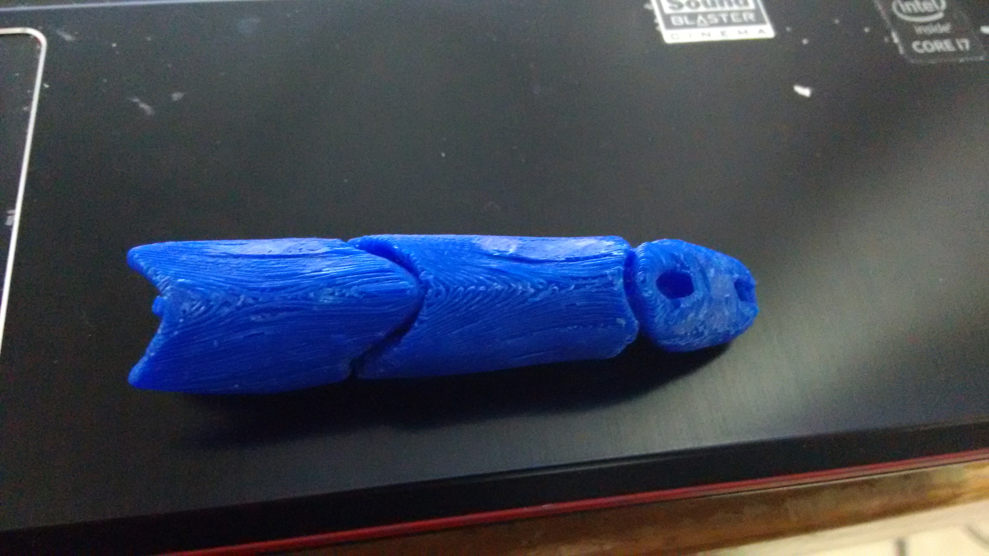

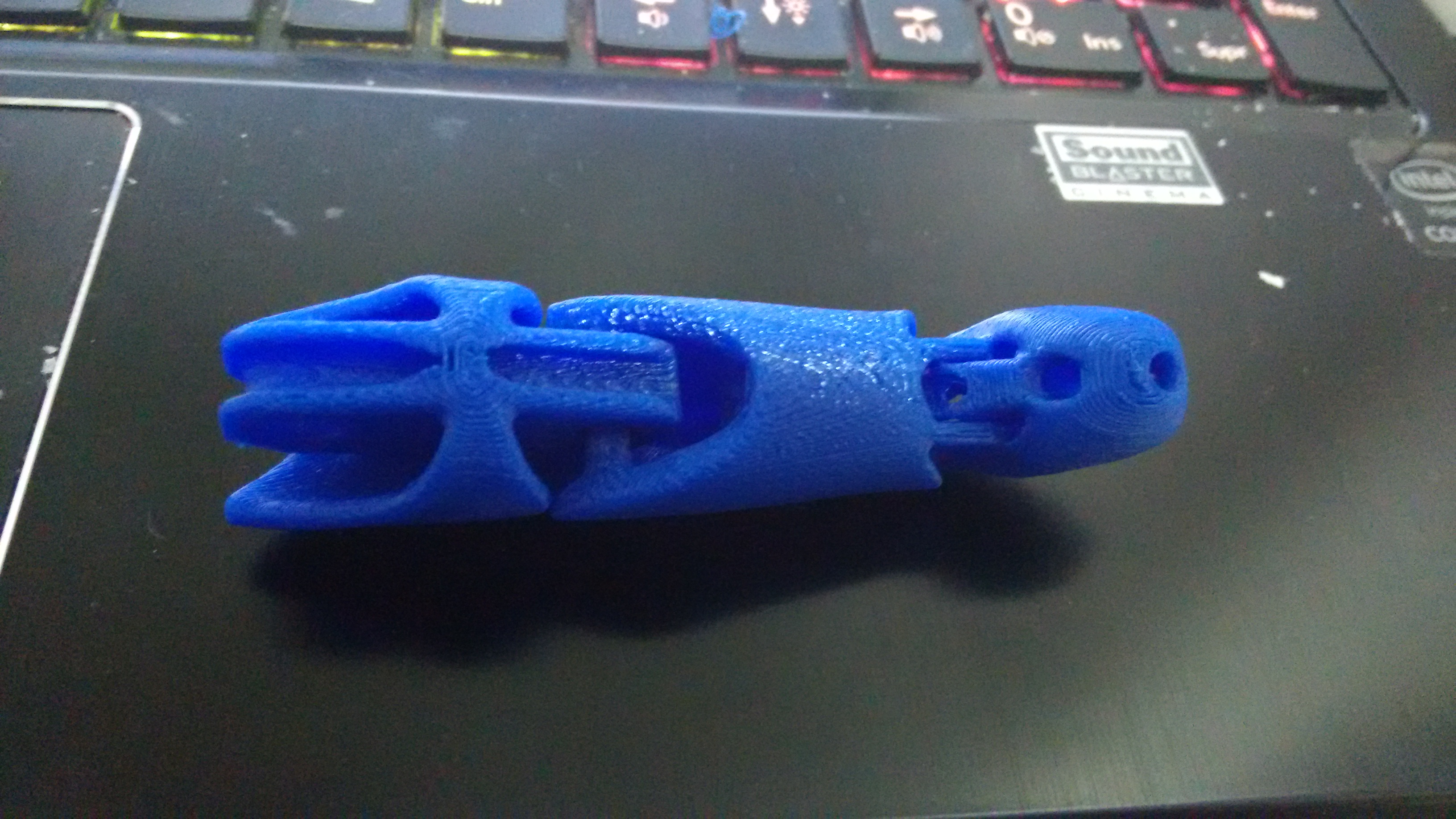

problem with bottom layer quality on support
Hi, i'm from chile and i need help.
when i print with support, the part of the piece that's in contact with the support, has a very low resolution, instead the rest of the piece has a very high resolution.
i dont know wich part of the configuration i do wrong to obtain the same quality in all the piece.
I have a leapfrog creatr.
salutes!

part of the piece that not have contact with support
piece that hace contact with the support

if you add dense support layers then open the gcode file in notepad.
"ctrl F" search for dense and change the speed to 1000 or so.
i get pretty good bottom layers as the dense support layer acts like a good base
