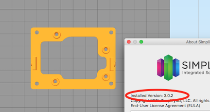

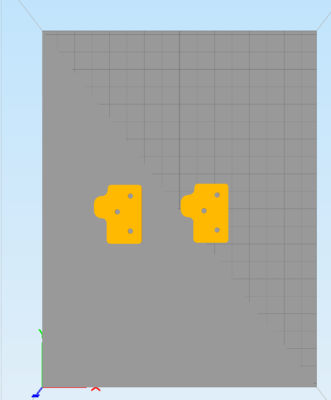

The bed grid lines disappear on various view orientations - only happens in 3.1 (another poor quality control check). Image attached.
Bed gridlines

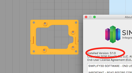

I use a Mac. Doesn't happen with earlier versions (I still have 3.0.2 loaded and confirmed no problem).
It's not a problem for me - just thought I'd post it here (and I don't expect a fix for it - they never fixed the Toolbar - probably only a Mac issue).

I think calling this a graphics bug as a result of poor quality control checks is a bit much!
What I believe we're seeing here is an unavoidable effect of a graphics processor where it is attempting to merge the pixels from a high resolution plane into a lower resolution render. I'm sure there's an official term to describe the effect.....but not being a specialist in the science, I have no idea what its called.
I've looked at my build bed in S3D from the same angle in three different versions (2.2, 3.01 & 3.1) and I get exactly same thing in all three versions, but its a somewhat different form of this effect ...where I get something that looks like moire fringing in a colour in between the grey of the bed background and the dark grey/black of the lines. Getting the same doesn't really surprise me as all three are using the same code to render the graphics image....the video graphics processor in my PC!

Agreed. I have a Mac as well, and it works absolutely fine for me on 3.0.2 and 3.1.0. No issues at all.

I'm curious, are you using a 32 bit version? I'm on 64 bit and I've not seen this before either, even when setting the build area unusually high (like meters large). It sounds kind of like Z-fighting, though.

Graphics are calibrated and no similar (or other problems) with any other software, including SolidWorks with it's intensive rendering in FEA and photo rendering with adjustable Light position sources, GIMP, Paintbrush, Coral, Autocad... list goes on . It happens only with s3d whether Legacy Graphics is checked or not (in prefs). Regarding Z-stitching: stitching is app/code dependent (polygon orientation and depth), not machine dependent so, it's s3d code.
