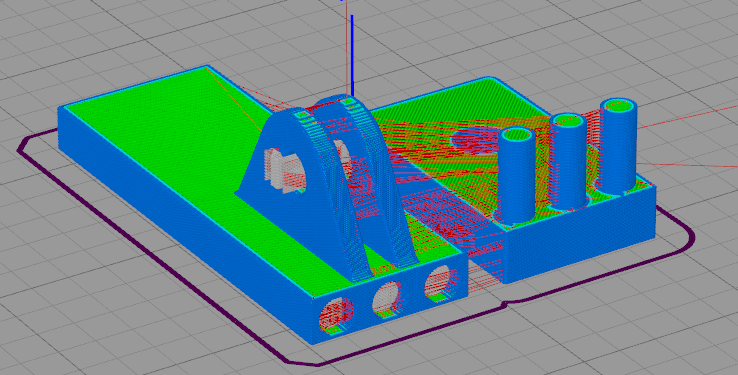

I don't remember ever running into this issue before (V3.1). I go into supports, click on automatically generate supports, then click on Remove Support Structure and remove the support structure that I do not want. Everything looks good, until I hit Prepare to print button and the print preview display the supports that were supposed to be removed.
Here are pics

Heutinck wrote:it looks like you tried to remove all the supports, you could always just turn off support generation.
I'm sorry, I should have added another picture. The second object has support underneath for a recess. So I'm guessing this is a bug?

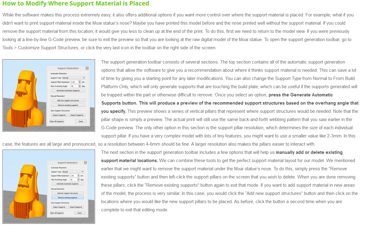

I am referring to this tutorial https://www.simplify3d.com/support/tuto ... tructures/. I don't see anywhere in it's instructions that alludes to or indicates that removed support structures will be generated anyway which is in fact what is happening. It seems to say just the opposite.
What am I missing here?
