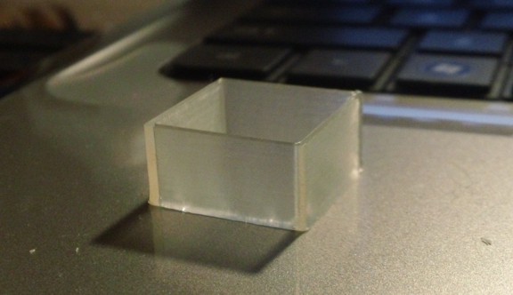

I have been working on a .1 mm thick layer profile for my m2. Im getting closer.
let me know what you think.
20 mm test cube
20 mm test cube
test cube.jpg (53.9 KiB) Viewed 276146 times
Re: 100 micron layer
Posted: Wed Mar 27, 2013 7:23 am
by Simplify3D
That's pretty impressive! I can barely see any horizontal layer lines and the surface finish looks incredible.
How about printing a slightly more complex object like a squirrel (http://www.thingiverse.com/thing:11705)? I'd be interested to see how the repeatability works out for something other than straight lines.

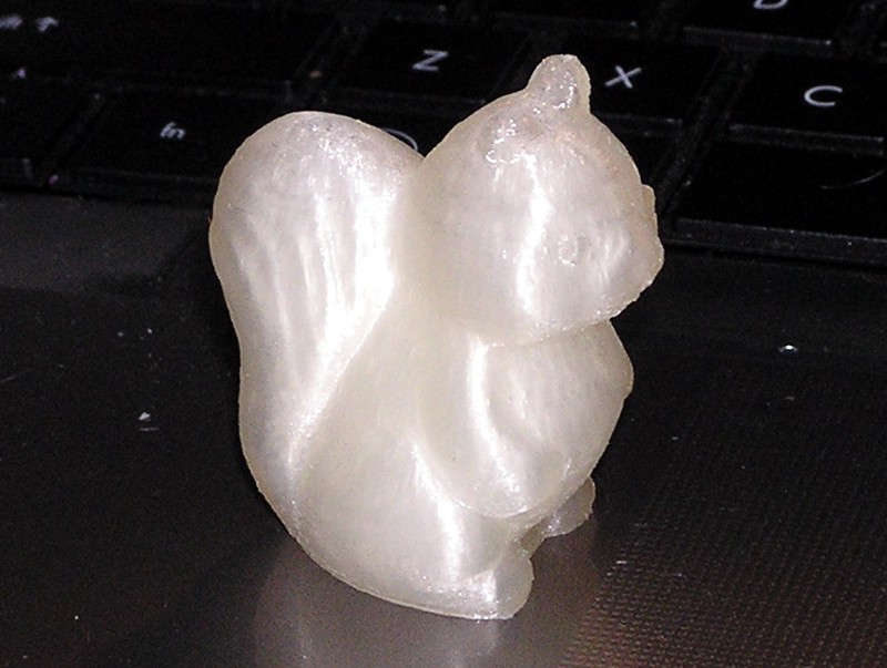

Here is the model you requested at 75%.
You can see there is still some room for improvement in my profile but most of the printlooks really good.
I can post the .fff if you want but its not perfect yet.
Let me know.
Shot 1
Shot 1
sqrl 1.jpg (244 KiB) Viewed 276111 times
Shot 2
Shot 2

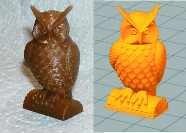

Sorry it took so long was out of town.
Attached is my 100micon .fff file I used to print the owl.
http://www.thingiverse.com/thing:18271
I printed it at 33% size its 1.92" tall
Some notes:
1. I have only got it tuned for PLA I will work on the ABS next.
2. I do run the PLA a little hot but it helps with the flow.
3. The way it is configured it will not slice a feature smaller than 1mm (.039")
4. You probably don't want to under fill at this thickness. It has caused some problems.
I will be happy to share what I have learned just ask.
I wish I was better at taking pictures as the photo doesn't do it justice.
OWL printed at .100 mm layer thickness.
.100 owl.jpg (174.86 KiB) Viewed 276068 times
100micron.zip
100 micron layer thickenss profile.
(1.02 KiB) Downloaded 798 times
Feedback welcome.
Posted: Sun Mar 31, 2013 7:52 am
by mir4k
Thank you slipshine ! The owl looks really good, so do the pictures. I will take a detailed look at everything you changed and give it another go myself. What do you mean with the 4th bullet ?
"4. You probably don't want to under fill at this thickness."
Do you mean that I should not use a very tiny value for infill ? (sorry for the most likely stupid question, I am new to 3d printing and english is not my mother tounge ;)
Posted: Sun Mar 31, 2013 9:34 am
by slipshine
I was referring to the % of infill. I believe it is set at 50% right now. You don't want to have it set too low like 15%.
I found that the grid pattern. was not very robust and would occasionally collapse on itself leaving a flaw in the part.
