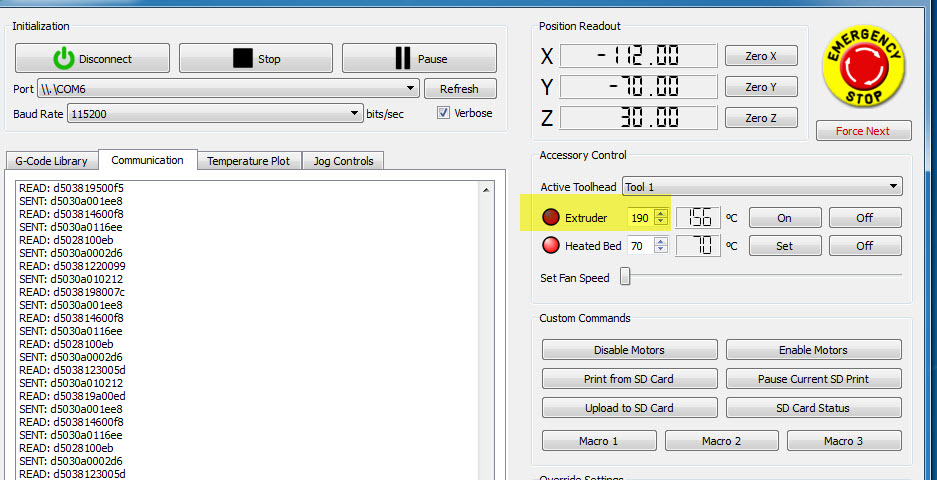

When I start a new print the heated bed light comes on and the target temp updates and the bed starts to heat. Then when it is time for the extruder the light does not come on and the target temp does not update but the extruder does heat and the current temp is displayed. The light and target temp used to work.

Thanks but I completely uninstalled and then re-installed and still the same behavior.
The software is sending the correct info to the printer but the lite in the S3D machine control panel in the software does not come on when the preheat of the extruder starts nor does the target temp update. The current temp however does show correctly.
The lite and target temp for the bed do operate correctly in the software machine control panel.

I can try to post something this evening if I get time. I tried it last night and ran my ABS which is on extruder 1 (right extruder tool T0) and it works fine. When I run my PLA setup on extruder 2 (left extruder tool T1) is when the temp light and target temp do not work (display) in the software control panel. Just to clarify, it does send the right info to the printer.
As a note, in my PLA setup I tried changing the bed id to T1 to match the tool id for the left extruder of T1 and then neither light worked. So it seems when I am using the left extruder or one not named T0 then it doesn't work.
