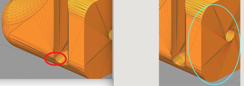

Last year I learned this lesson the 'time-wasted way' (by doing a long print) but was curious if problem was fixed so, I revisited the lesson after seeing others with file repair problems
Imported stl, received manifold problem
Repaired it in s3d and Removed orphaned/duplicate...
Printed it - Result: - bad print!
Did the following curiosity test in step-wise manner:

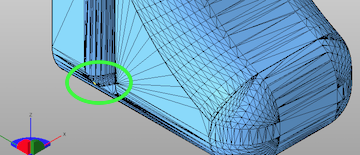

Imported the same stll, received manifold problem (screenshot One/Two)
Identify self-intersections (screenshot One/Two)

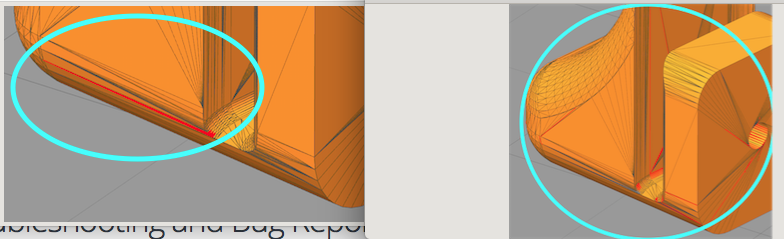

Repaired it in s3d and removed orphaned/duplicate... This made it even worse (screenshots Three/Four)
Repaired it in Netfab (stand-alone verson on my computer) only problem is hole (same as screenshot One).
Exported it, imported into s3d - no manifold/triangle... problems.
Point being, the repair/healing feature is not trust-worthy, thus, worthless (this software should be either Free until they fix bugs, and certainly they should publish fixes more frequently than once/year :evil:

greybeard wrote:Point being, the repair/healing feature is not trust-worthy, thus, worthless (this software should be either Free until they fix bugs, and certainly they should publish fixes more frequently than once/year
Model repair is difficult, especially with as crappy of a filetype as STL. Maybe they should do like EOS and say if the model isn't perfect, we won't work with it at all...
Come on, be constructive at least. Most of what S3D does is only good for identifying that a file has problems. The remove duplicate function isn't very helpful because almost nothing actually has the problem that it tries to fix. What it does do, though, is removes very small triangles like the ones highlighted in your second image, which is not exactly a repair (quite the opposite, in fact).
