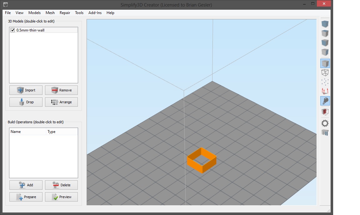

When slicing the calibration object 0.5mm-thin-wall.stl from http://reprap.org/wiki/Calibration
Using the default m2 config
I get this result, which is only the first layer, and then the print head just prints a vertical line from one corner of the object.

It's because you are trying to model a 0.25mm thick wall with a 0.4mm thick plastic extrusion. The slicer won't lay down plastic there because it would go outside of the part boundaries. This is just the nature of how the slicer performs, and it's the same reason you get such good tolerances with normal parts.
If you manually set your extrusion width to something below 0.25mm it will slice correctly (this is a good "hack" for when you want to print unrealistic things like this), or you could modify the actual STL file to have thicker walls. Either works.
Does that help?

Although it didn't print very well when I unchecked Auto-Extrusion and set it to .24, not enough filament was coming out.

Ah, yes you're correct. I forgot to mention that. Changing the width will make the software think you don't need as much plastic since you're only printing a smaller width*height area. You would also need to change your extrusion multiplier accordingly. It would be roughly linear, so if you halve the area, you should double the extrusion multiplier.
What you see with a lot of STL files that are intended to have a single wall nowadays, is that they actually make the entire interior of the model solid and you simply choose zero infill and zero top or bottom solid layers. That's really the preferred method for doing this.
