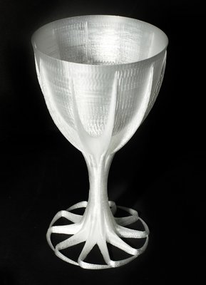

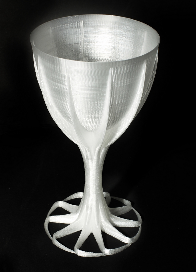

This my default ABS 0.2mm Layer height profile for the right extruder. It's based on Enginewiz's Replicator 2 profile and works great.
You may need to fine tune it to suit your filament diameter etc.
Let us know how you get on,
Steve
"Spoke Goblet" printed with this profile

For endymion: Sorry I didn't chime in back when you originally posted. I've been doing a bunch of tuning myself lately, using the MAKE Magazine Torture Test object, and I'm getting a better feeling for the settings and their sensitivity. Looking at the photo of your part, I'd suggest increasing the Extrusion Multiplier, especially if NG3D's FFF profile has reduced from Creator's default value for the Rep2X. Once the layers fill in pretty well, start using the retraction and coast settings to get rid of blobs and stringing (by increasing them) or to get circles to complete (by reducing them).
