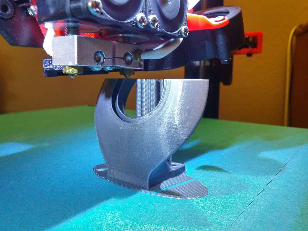

It would be great to only have the raft be created just around the first layer of the build, not the entire "shadow" of the object. This can create a raft that is unnecessarily large and cover holes that may be at the bottom of the object - or at least have both options - create full raft or just around outline of first layer. We should still be able to control the offset in either option. Thanks!!
unnecessary raft size - shadows entire object.
