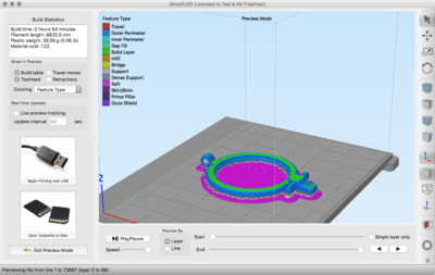

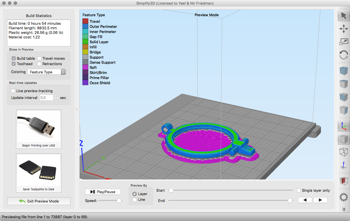

The raft feature has tendency to fill the shape outline. This means that if I am printing a circular object (that might be thin) Simplify3D creates a complete circle raft, most of it wasted.
