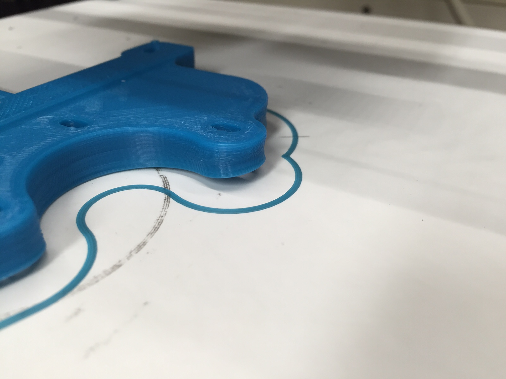

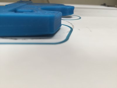

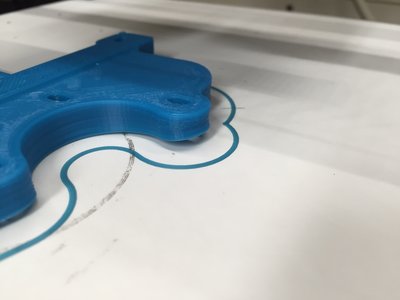

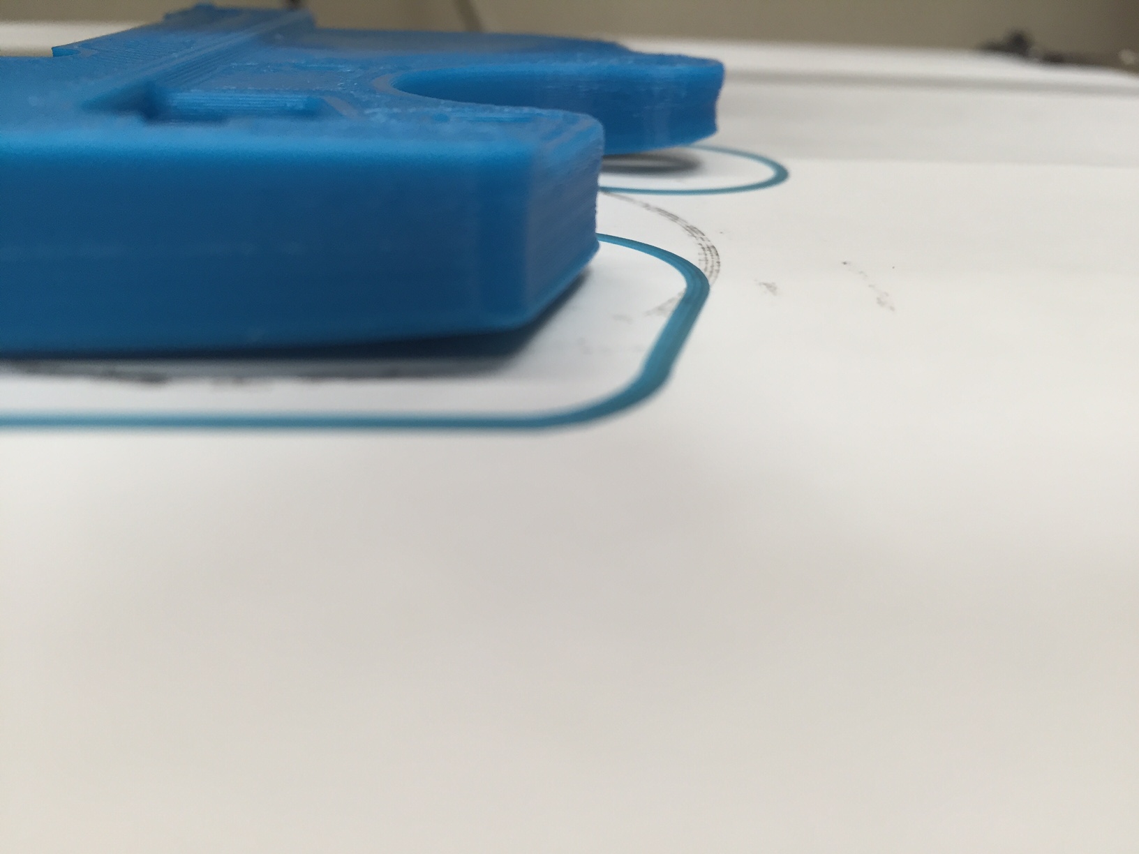

Hello All,
I'm trying to print with 85% infill, but I 'm having a lifting problem with ABS. Any thoughts.
I can provide the FFF if needed.
tenaja
Posts: 156
Re: ABS lifting
Do a search. This is the most common problem with abs.
Abs requires a heated bed and chamber. Lower print temperatures also help.
