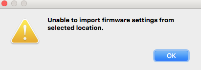

Then, booted s3d and received Error Message (attached)

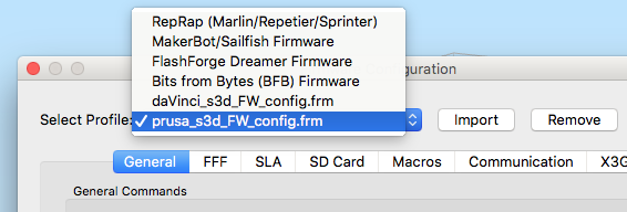

I imported the xxx.frm's into the firmware panel.
However, my profiles and Firmware appear to be loaded (attached)
Not sure what I missed but, HOW to point s3d to settings location and stop the error (happens each time I boot s3d) ?
Error Message
Error Message
Firmware Panel
Firmware Panel

That probably means that you either moved or renamed the file, so now it can't find it. Just remove it and then import it a second time. Then go back to any processes that were referencing that firmware configuration and update them as well.
greybeard
Posts: 178
Re: Internal Setting Location... error
Thanks - that worked
Naturally, I re-imported it and that alone didn't work.
What did work was to First delete them, then re-import.
