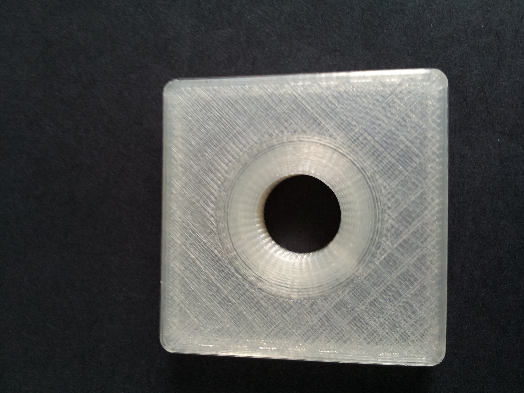

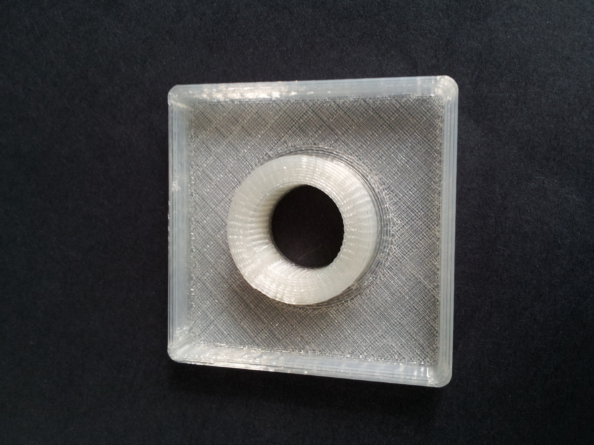

greybeard
Posts: 178
Re: Controlled fill density around holes
Doing it as separate parts (solids, not shells) with individual processes work well. It's the only way I'm able to do it.
As an example: Using Solidworks to model the complete part, then cutting the boss out and making two individual parts.
Then, process one with 2 shells, the other (the boss) with 6 shells (to yield 6 outside and 6 inside shells around the boss... No witness lines.
Images attached.
Pre-Print
Pre-Print
Outside
Outside
Inside
Inside
