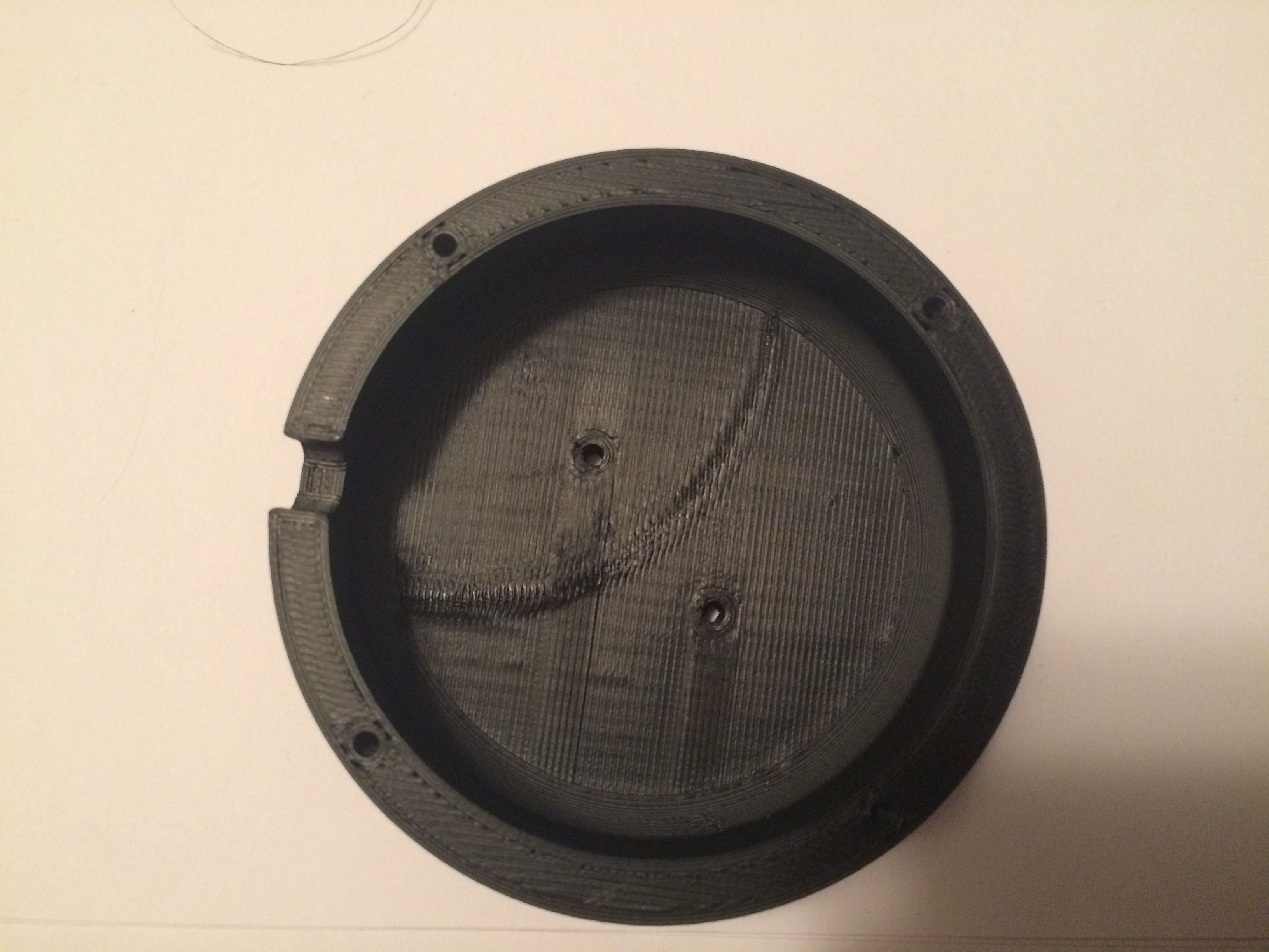

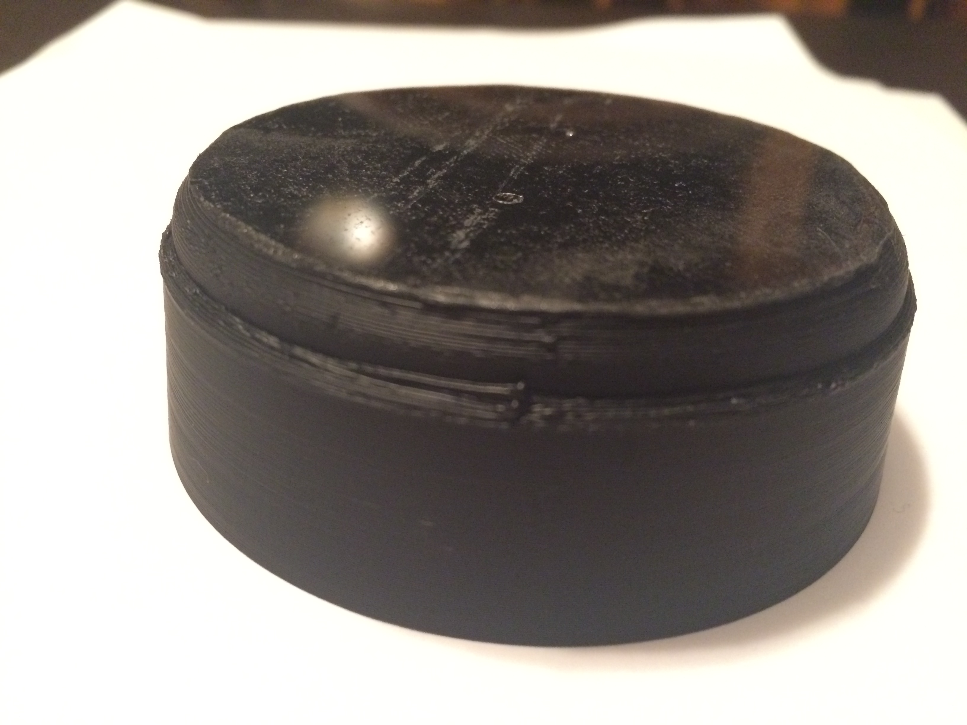

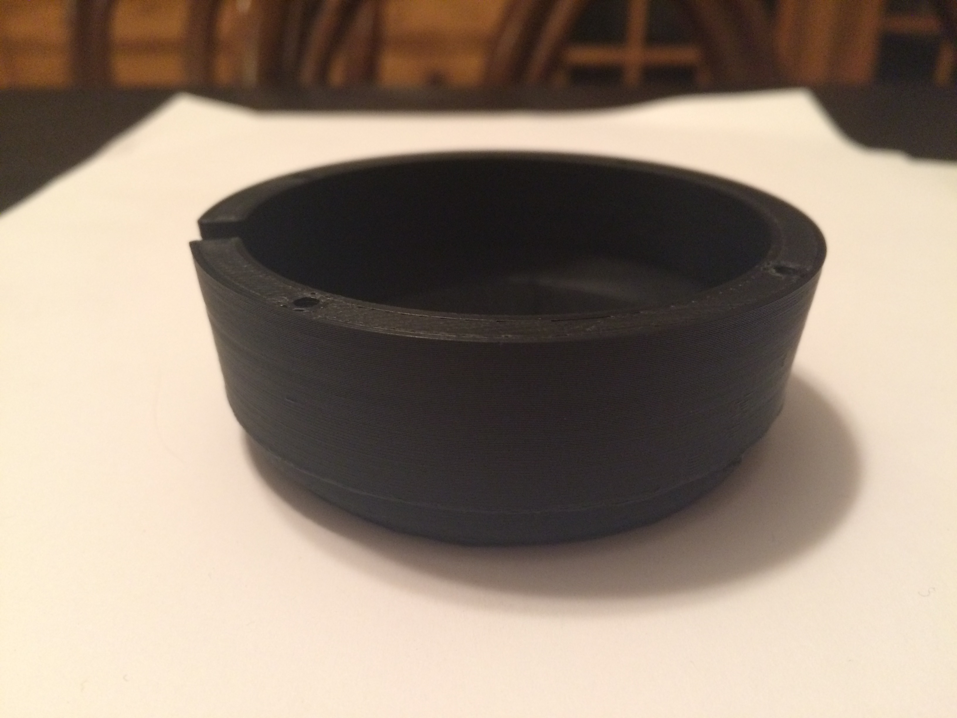

I am trying to print out a lid for a part. I've been printing it like a bowl (see picture), however a consistent ridge along the outer part forms. It is about the same width around, which means that the part isn't shifting. Has anybody had this problem and solved it?

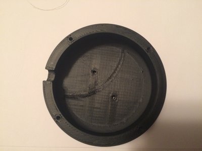

The arch in the bottom of the bowl consistently appears. It's always in the same place.
How it was printed (like a bowl)
The ridge
The ridge

The mark on the bottom of the bowl is the extruder nozzle moving to close to that layer and melting the plastic. You can't do anything about that unless you somehow change the toolpath of the extruder.

If the ridge is to the bottom when printing then I would say it needs some supports since it looks to be printing in air. Maybe the extrusion multiplier is a bit high also?

wirlybird wrote:If the ridge is to the bottom when printing then I would say it needs some supports since it looks to be printing in air. Maybe the extrusion multiplier is a bit high also?
When I added support (22% regular, 35% dense), it generated supports, but they didn't go as high as the ridge. I'm not sure if supports alone will work.
I tried printing it like an upside down bowl, and the ridge went away.
The extrusion multiplier does seem a tiny bit high (mm bumps where the head lifts off). Thanks for the suggestions.

FYI, the arch in your first image is most likely an impression from your second extruder as it travels over the already printed part.
For information, if you have this issue again you will need to add support manually.....which is quite easy to do. Try it now on this object so you get some practise....
