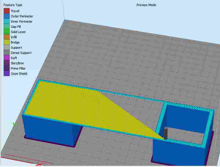

Hello,
I want to print the attached factory-file.
When I prepare it for print, I notice in the preview, that there is a very long bridge from left to right.
It could be replaced by a much shorter bridging distance, if it would be turned by 45 degrees.
I have already tried rotating the model, but it is not influencing the bridge.
Is there some possibility to influence the bridging direction (sth. like the infill orientation)?
Greetings
Florian
FanDuctAdapterDuct.factory
(43.95 KiB) Downloaded 425 times

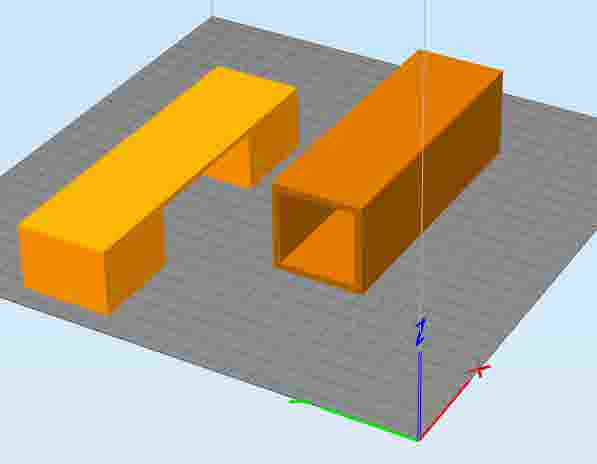

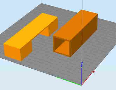

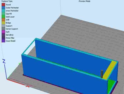

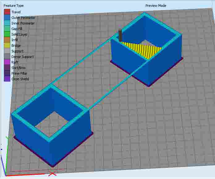

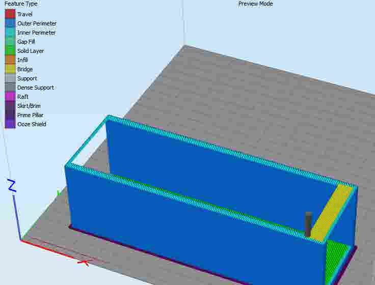

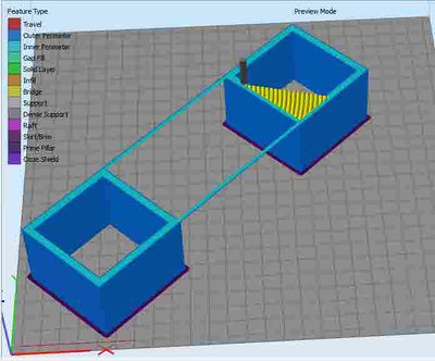

... i is very amazing how S3D handles bridging
Two simple examples:
the test -modells
the test -modells
along a axis and turned 45 degrees

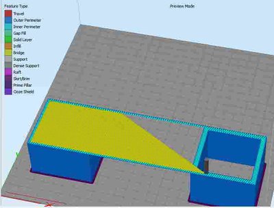

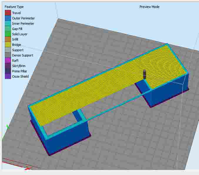

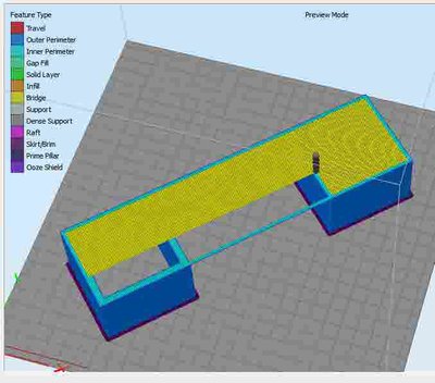

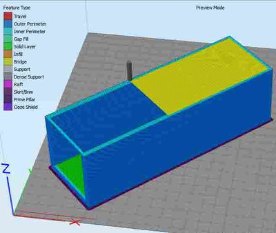

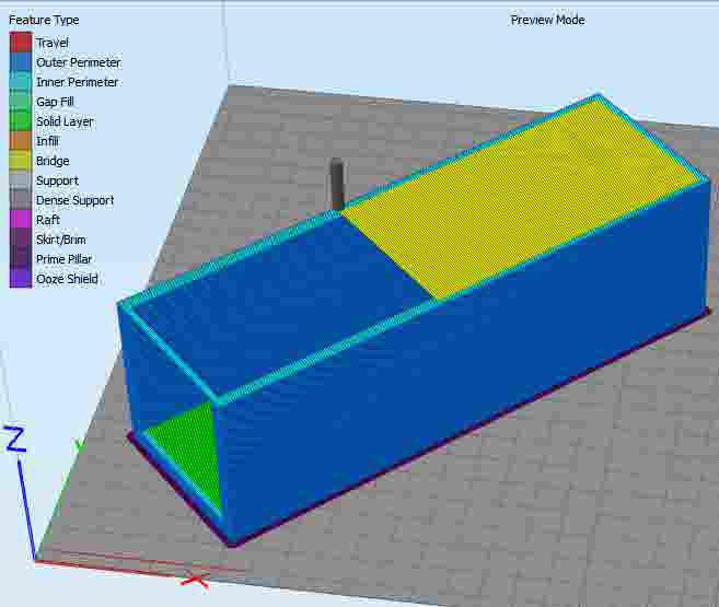

Posts: 861
Re: Influencing the direction of bridges
here the table-like object:
here along the axises

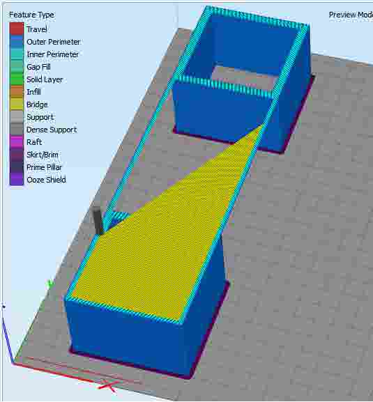

Posts: 861
... and here turned 45 °
the tower ist covered first in diagonal direction, followed by covering the middle and separatly the second tower in long-way direction.
That is extremly different to the system of bridging, when the object are lying along a axis.
A second test shows an other methode. There, after covering the first tower in diagonal direction, the middle part and the 2nd tower is covered at once and in long-way direction .
I couldn't find out the reason.
