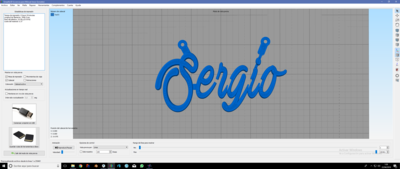

I have problem printing letters, the first photo is the model to print, but then I separate the letters by holes when making the filet, how can I fix it?
Thank you very much for your help.

Can you post your factory file (File > Save Factory File)? I would suspect the problem is that your model isn't a valid 3D solid, but it will be easy to check when you attach the file.
reemaj3d
Posts: 11
Joined: Mon Sep 19, 2016 5:19 am
Re: Problem with printing letters.
There might be errors in your 3D file just like CompundCarl said. Try https://makeprintable.com/, is a good free tool for inspecting and repairing 3D models

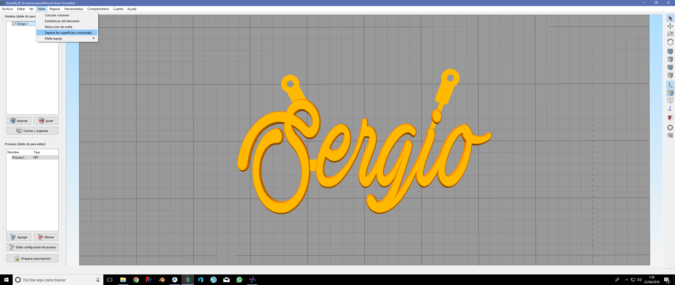

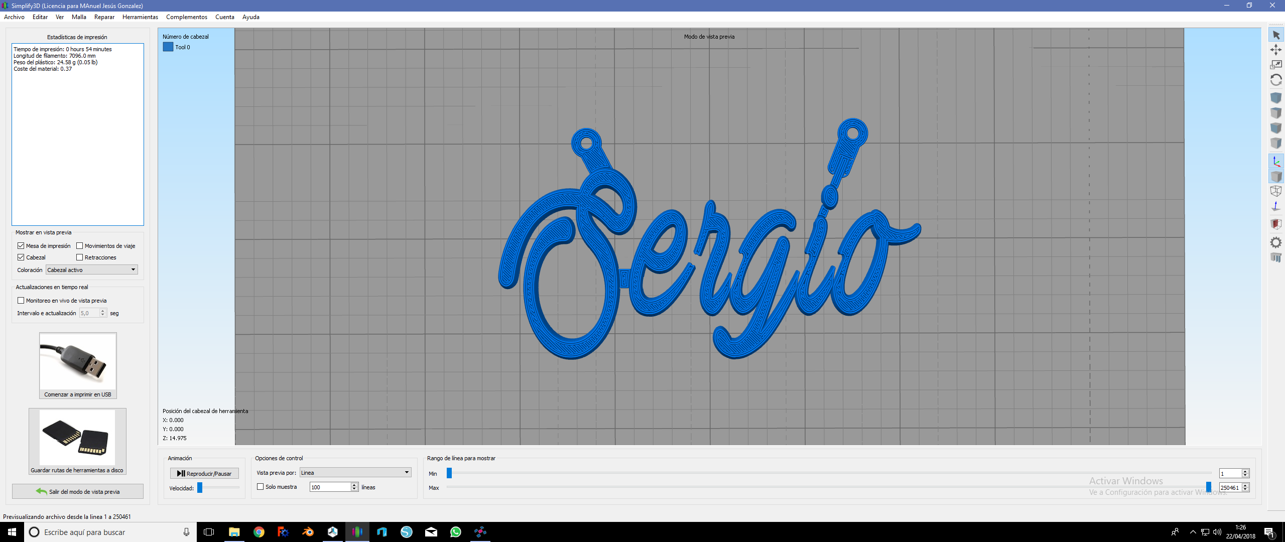

Después de darlo por perdido durante tiempo, al final lo he solucionado!! :D
En la pestaña "Malla/Separar las superficies conectadas" y funciona!!!
