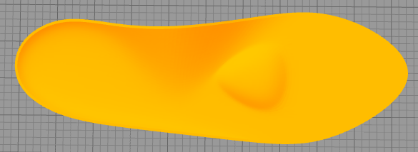

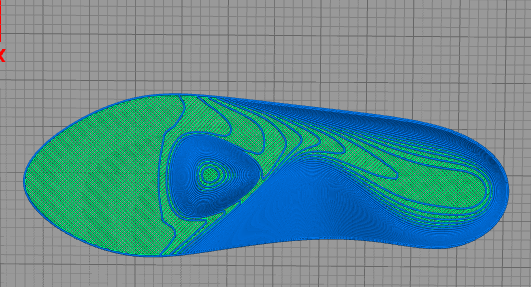

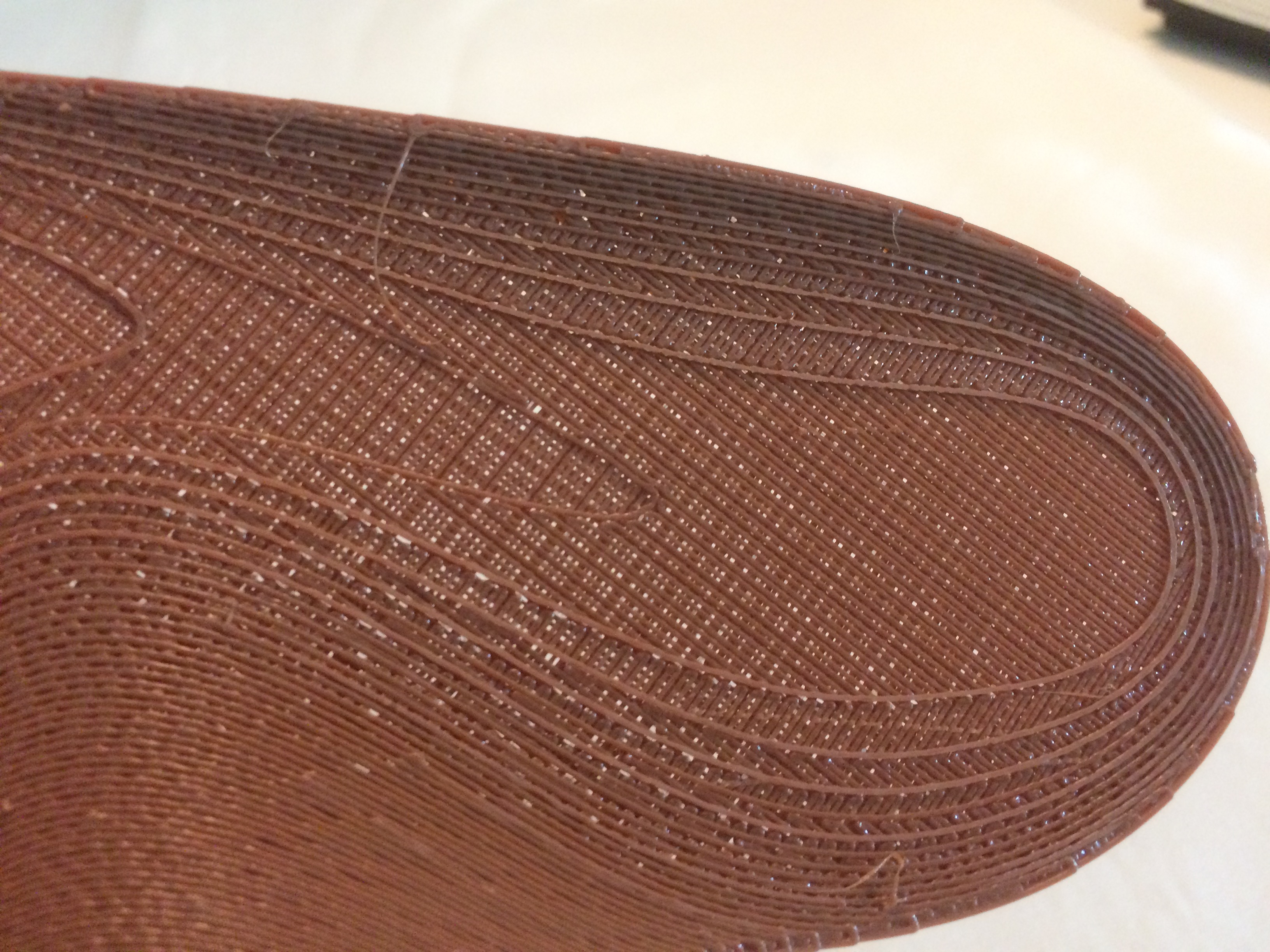

I 3d print insoles, and would love to have a possibility to change last layers for a more smooth surface. The reason being that the insoles have curves (stairs) as shown on the pictures. I print with high speed and large nozzle, but then the contours become very visible. I can't really use a process only for the last layers, because of the curving shape. Any suggestions to how I can improve the print (minimise the contours)?
Re: Finish layer
Seems like a duplicate of this post: viewtopic.php?f=9&t=6410&p=27849
There were suggestions posted there
