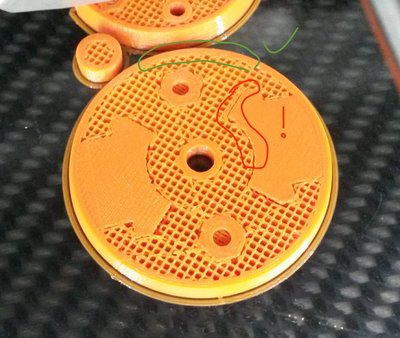

I'm having troubles with proper bonding of infill and top solid layers. The missing bond makes the printed parts less strong! There is a nice option, which controls the overlap percentage between infill and outline. Unfortunately this parameter seems only to control the overlap with perimeter lines, but not the overlap with Top or Bottom Solid Layers. Is there another parameter to control the overlap?
Gap between infill and top solid layers (printing with UM2)
Preview in Simplify3D

Did you ever receive an answer to your question? Or were you able to solve the problem?
I am having a similar issue. No matter how high I set the "Outline Overlap" percentage, the prints have a gap between the infill and the perimeter wall sections, particularly circular forms.
I will post a new topic in this forum to try to get an answer. If you are interested in hearing any response that I get, let me know and I will send it your way.

No I didn't get an answer yet, but I'm still interested to know a solution.

See viewtopic.php?f=9&t=3822&start=48
I can't understand why S3D doesn't fix this glaring deficiency which has been a source of aggravation for years.
