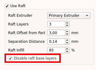

Well, apparently there is an option I can use to prevent this in the raft options: "Disable raft base layers"
I've not tried it yet but thought if someone else has the problem I have or maybe had he may stumble upon this thread here.
Re: Filament grinding while printig the raft
Posted: Sun Dec 25, 2016 7:40 pm
by dkightley
Disabling the raft base layer will only help if the filament grinding is taking place on the three layers that make up the base layer...and not on the other raft layers.
