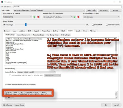

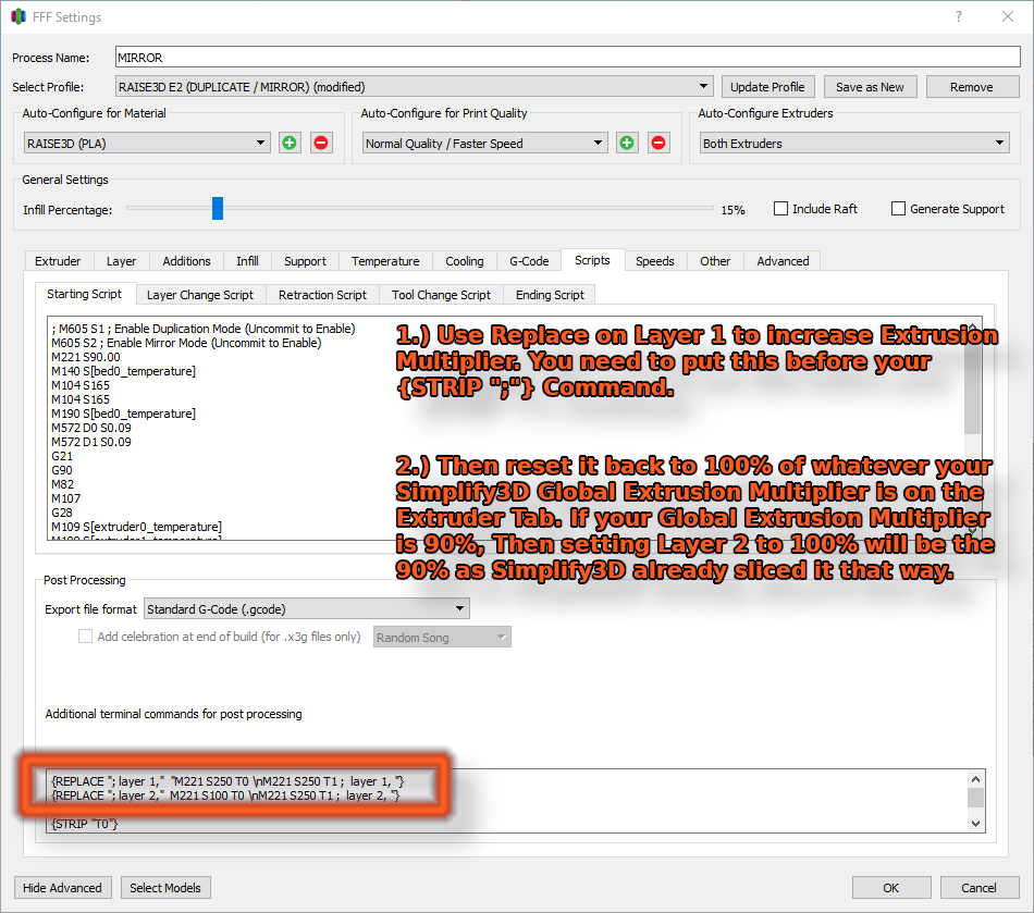

Re: Extrusion Multiplier for first layer Please
Wish Granted! :)
1.) Use Replace on Layer 1 to increase Extrusion Multiplier. You need to put this before your {STRIP ";"} Command.
2.) Then reset it back to 100% of whatever your Simplify3D Global Extrusion Multiplier is on the Extruder Tab. If your Global Extrusion Multiplier is 90%, Then setting Layer 2 to 100% will be the 90% as Simplify3D already sliced it that way.
-Jason

blj1884 wrote: ↑Fri May 27, 2022 4:09 pm Wish Granted! :)
Just a note:
Check if your printer does support M221 and what parameters it's using before adding this.
This is dependent on the firmware running on the machine, older ones like Sailfish don't
understand M221, others (RRF) might require a "Dxx" instead of "Txx".

parallyze wrote: ↑Sat May 28, 2022 9:58 am
Just a note:
Thank you for refining my solution.
