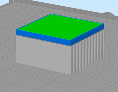

With standard Support:

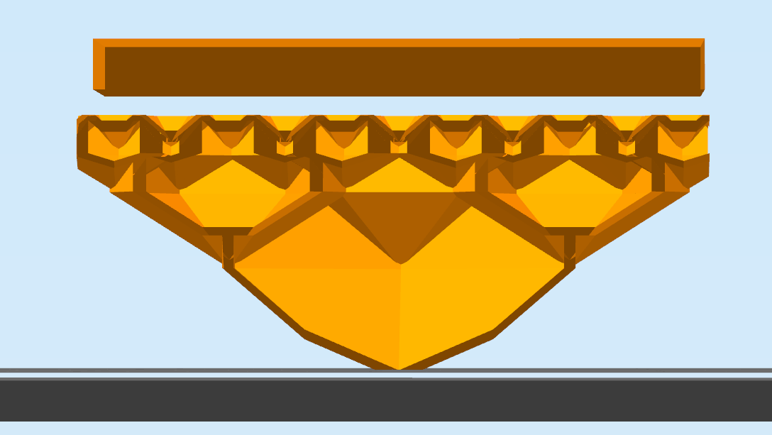

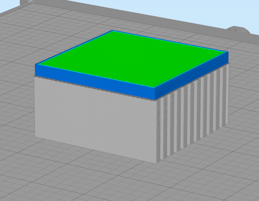

With fractal hex columns

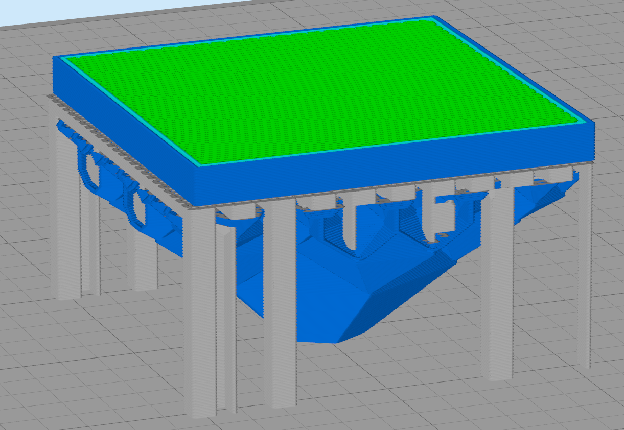

Cross section so you can see the fractal hex columns
I've not optimised this yet but even a rough attempt saves a LOT of filament.

Immediately under the part you have the interface layer, underneath that you would have a grid of hexagons small enough for the interface layer to sit on. The each lower slice you shrink the hexagons by 0.5x extrusion width and join the corners of the hexagons together. When the hexagons shrink to near zero size the lines joining them basically form a new larger hexagon and you continue the process with them until you hit the build plate :)
