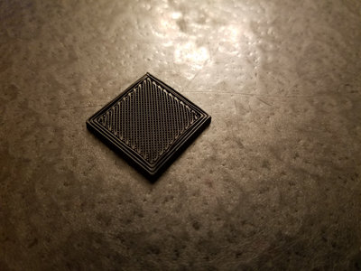

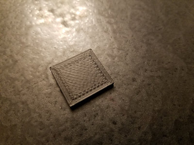

I need some advice on figuring out how to fix my first layer. I've been trying to learn how to calibrate my extrusion multiplier, but I cannot seem to find a good balance. The bottom layer always seems like not enough plastic is extruded, but if I increase, the top layers become a mess.
In this print, the top layer looks pretty good. The edges are fairly square (though could be improved). I'm not sure if this is relevant, but the first 2 layers seem like they've shrunk compared to the layers above (forming something like an upside-down trapezoid).
I'm printing with ABS (Village Plastics - Black)
Top
Top
Bottom
Bottom
Any advice would be greatly appreciated.
