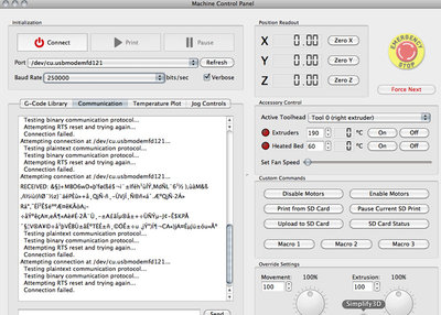

I'm having the same problem trying to talk to a RAMPS 1.4 via USB from a MacBook Pro running 10.6.8. The Arduino is set up for 200K baud. Creator tells me that 200K baud is not natively supported by Mac OS, however I am able to talk to this printer using Repetier Host without any problems. I'd really like to be able to use Creator with this printer.

Hi Julia,
Mac dosent work fine with the Baudrate of 250000. If you change it to 115200 your printer will work well i think.
(the baudrate on your Host(Simplify3D) and your Firmware(Repetier,Marlin,Sprinter?) have to be the same.
