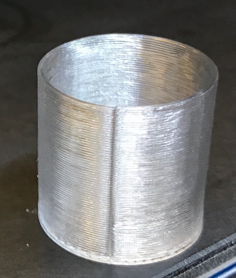

Hi there. I've been trying to print a cylinder with colorfabb xt petg. Initial prints were pretty rough. I was able to get the quality better, however I had to use an extra restart distance of -.35 and a coast of .10. Using wipe just spread the issue all over. this is causing what I suspect is under extrusion after the layer change. with the settings as is, the seam is indented on both sides. The side where the extrusion happens around the layer change isn't as nice as the other side. with a clear material I expect to see the seam, just isn't expecting this much.
does anyone have a profile for me to try or suggestions?
printer is a qidi tech I with a .4mm MK10 nozzle.
245 degrees with a 60 degree bed along with a -.2 on the Z is getting pretty good adhesion.
attached the profile
Thanks!

one more picture

suggestion on how to tune this a bit so i can get the seam cleaned up without sacrificing the other areas? Vase mode won't work for the end product which is a small container. on a side note it does print nicely in vase mode, the issue is stopping and layer changing.
thanks!

Mine come out the best when I print two. Align them equal distance from the center point in the bed. Then use that point for the start points. My seams are bulged just a little bit outward at the seam on the outside. Only slightly on the inside. Pretty smooth there and easy to clean up the seam on the outside with a fine belt sander. It would be better without the seam of course, but it does function.
Looks like you may need to try to give a higher extrude percentage. Not much. One or Two percent increments. That may fill your seam better.

Start reducing the negative restart. -.35 is a lot.
