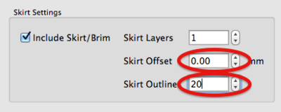

Have you ever tried using a brim rather than a raft? A brim can be defined as a skirt with ZERO offset, allowing it to attach to your part and stabilize it. The Brim Setting is in the LAYER tab.
To create a brim, enter a zero offset and then as many outlines as you want (I have 20 outlines shown on my part). I use brims for delicate spindly parts as well as things like chainmail bracelets. Brims basically crack right off the finished part leaving minimal cleanup.
Brim feature found in Layer tab
I think you basically have to experiment to find the best solution - it might be supports, rafts or brims. At least there are options!
