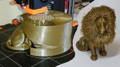

Hairy prints are booming at the moment. If you go on twitter and type: #hairyprints you will find a lot of awesome models.
Like this lion.

Neat example! So do you just cut away the outer ring beyond those hairs? Why is that needed?

The outer wall/ring is there to hold the outer end of the "hair", so in essence the hairs are long bridges from the model to the sacrificial wall.
