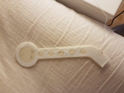

Hi everyone,
I have this problem when I print with PETg that my top surface looks blobby (please see picture.)
My infill settings are:
Internal fill pattern: Grid
External fill pattern: Rectilinear
Interior fill percentage: 50%
And I have 5 solid top layers.
Please help me, not sure what else to do?

Could be pillowing. Air in the pockets in the grid is expanding. Might need to print slower, maybe use a little bit of cooling fan. Try a lower infill %, the less plastic you have, the less heat you will have.

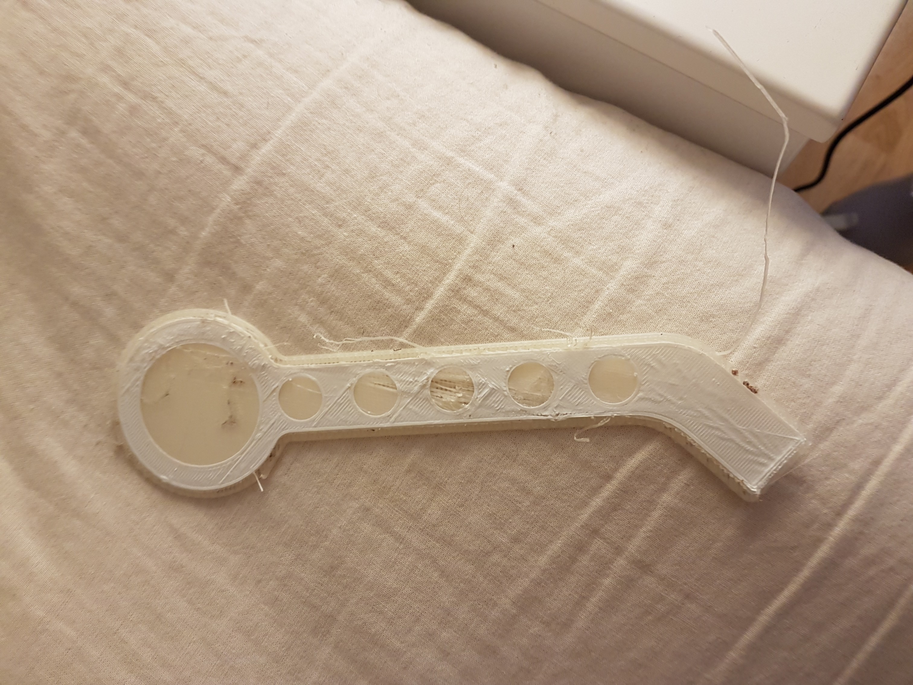

JSField wrote:Could be pillowing. Air in the pockets in the grid is expanding. Might need to print slower, maybe use a little bit of cooling fan. Try a lower infill %, the less plastic you have, the less heat you will have.
I just tried with fan on 30% and I got this mess...

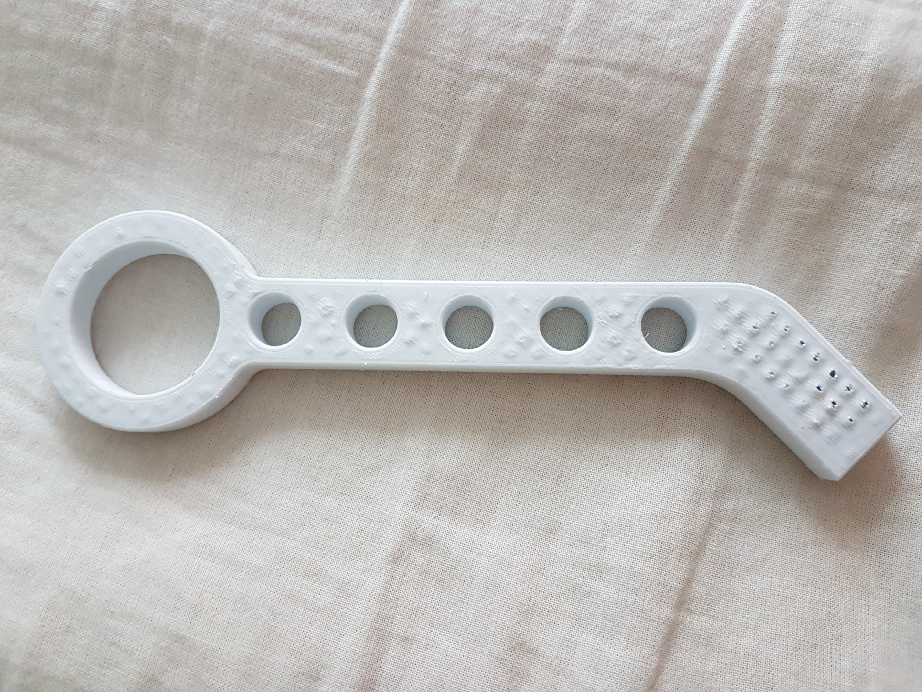

Okay, since I don't seem to be able to use cooling fan, I disabled it again and tried to lower the infill down to 35%, you can see the result bellow.
It is even worse now, since it has holes in it, I am still using 5 solid top layers.
Is there a possibility to use cooling fan on just the top layers? To see if that will make any difference.

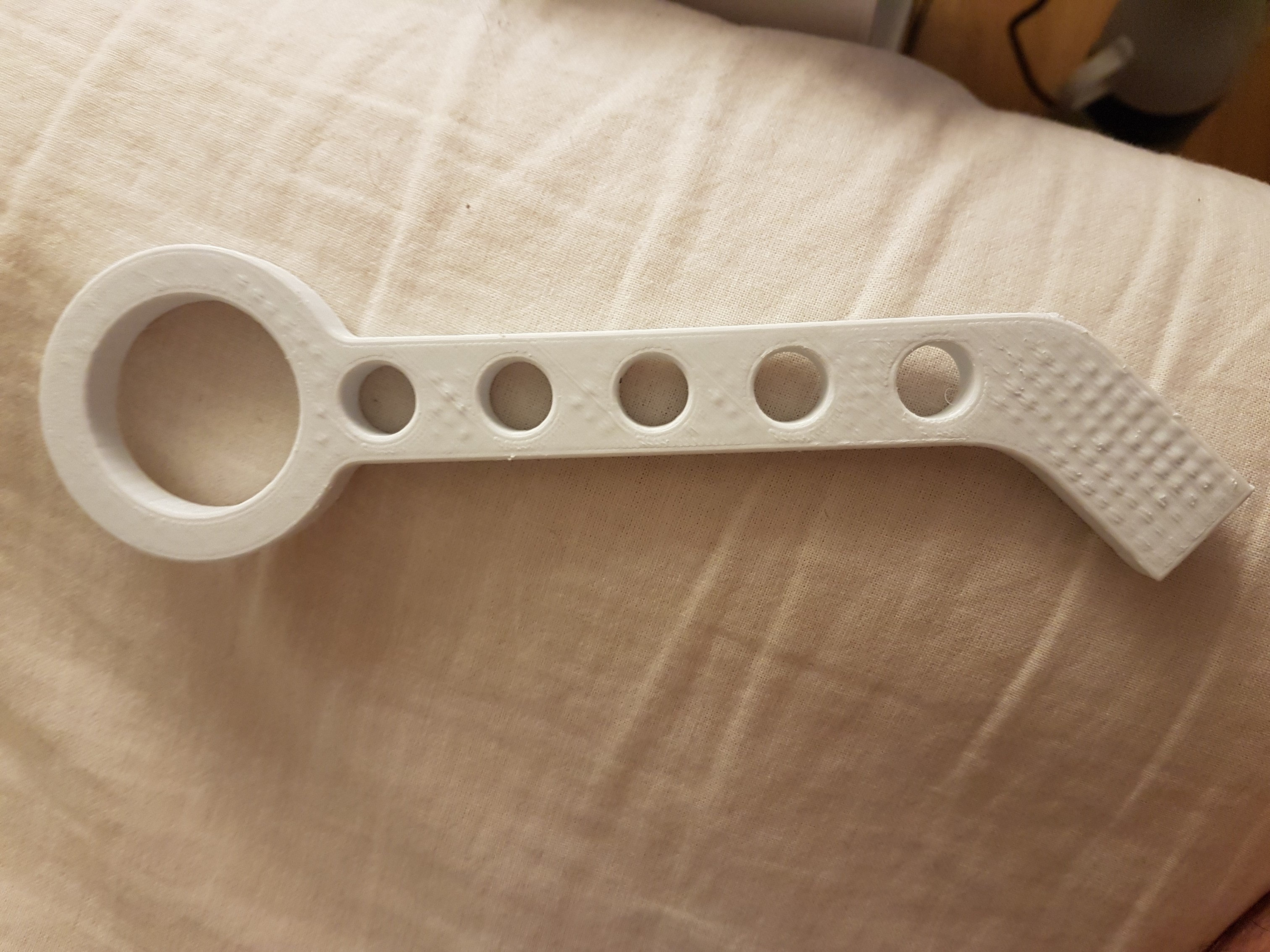

Re: Top surface with PETg
It is pillowing and PETG is very prone to this. Increase the infill to at least 40% and add top layers.

Posts: 1374
Cooling fan is optional. With the fan you will get better looking surfaces but without you will get better bonding of the layers.
Go back to where you started and add some more layers. The infill type will also dictate how the layers respond. So 50% with 7-8 layers and see how it goes.
