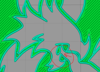

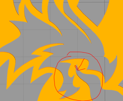

My Printer doesnt want to connect this. Please help
Posted: Wed Mar 22, 2017 3:30 pm
by ScreamEngineer
Wont connect
Wont connect
Even though it is connected here.
Does anyone know how to fix this? I've look at the support page, google, and the quality print post. Help would be very much appreciated.
Re: My Printer doesnt want to connect this. Please help
Posted: Thu Mar 23, 2017 7:36 am
by brian442
Set the extrusion width to manual and then lower the width until it can print the connection. So if you're at 0.4mm right now, try 0.38mm or something like that.
