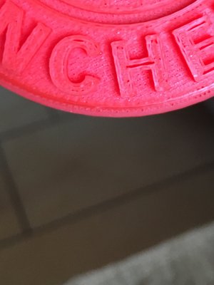

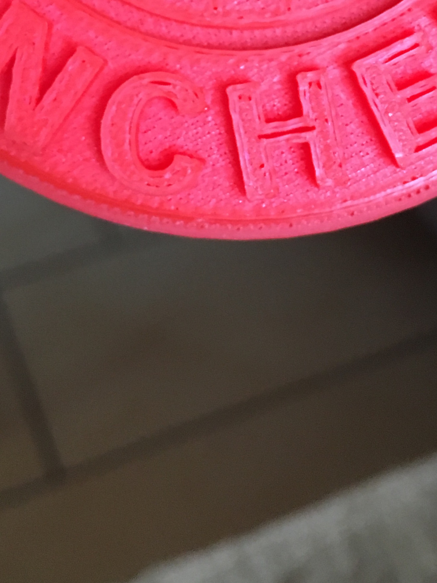

Hey,
im new with Simplify3D and need some help ;)
I test this object with some different parameters but i get these holes like at the Picture at other Models too, what ive done wrong ? Factory file is included.
Thanks for help.
Regards Showtek

There's a few topics on the S3D print quality guide that look similar. Here's one of them:

Re: Holes in the printed Object PLA
The suggestion of increasing the Infill Overlap did help me with this but then I started getting "Scars" on the top surface....
I've spent hours playing with different settings with minor improvements...
Its getting really frustrating actually because if I use the default Cura settings I get no holes and a good surface finish...
I'm stumped because I need some of the functionality of S3D, but the finish quality that Cura produces....
Yes with the Software from my Printer Ideamaker i dont have these Gaps too.. I Change the outline overlaps to 35 % but some gaps are there too.
Thanks for help.
