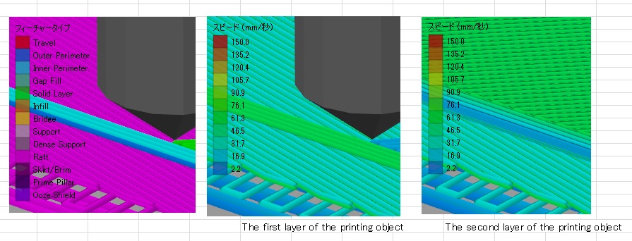

After the raft is created, the printing speed of the Outer Perimeter and the Inner Perimeter of the first layer of the print target is abnormal. From the second layer it seems that the speed will be normal. Is this a bug?

It always prints the layer on top of the raft at a different speed to help with separation. So that's normal and how it's intended to work.

Hi brian442,
I mainly focus on shaping something very small.
Since the modeling speed of the 1st hierarchy is too fast, the filament will not settle on the raft. Therefore, the shape of the model has collapsed. I want to slow down the speed of the first hierarchy and secure it firmly in the raft.
Thank you.
Re: about print speed
Posted: Thu May 18, 2017 10:27 am
by ViperZ
As shown in the following picture, if you create it with IdeaMaker it will succeed but when you create it with Simplify3D it will collapse from the first layer.
It is meaningless to purchase S3D with this.
I would like an option (CheckBox) to lower the speed of the first layer immediately after raft.
