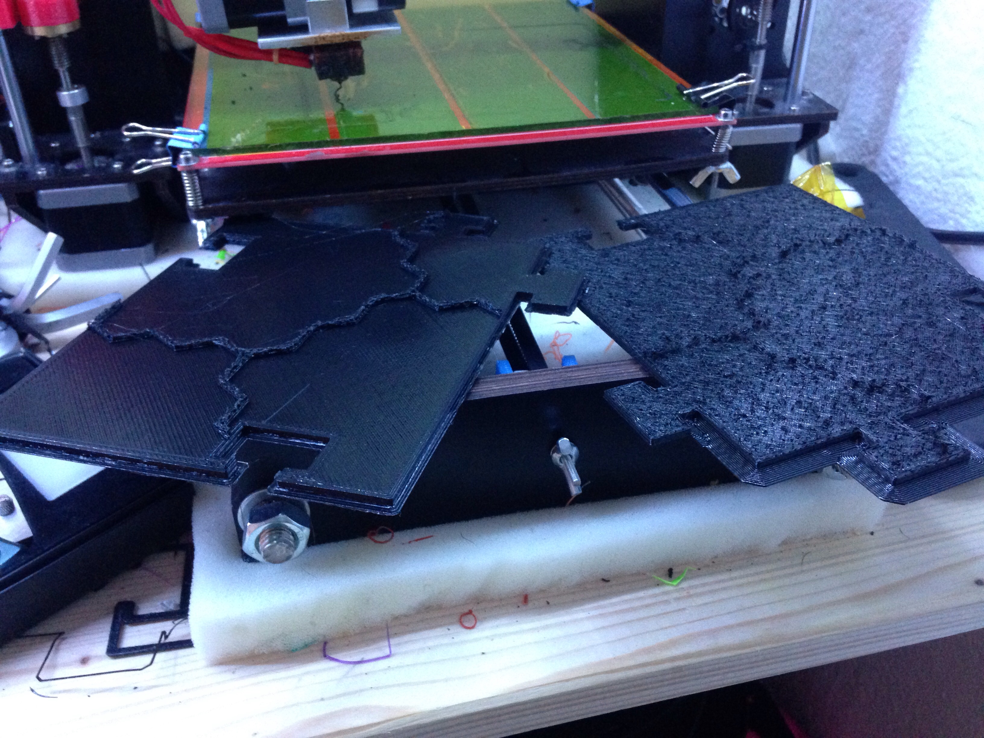

Dear Community,
I'm not entirely new to 3D printing, but it looks like for this issue I would really appreciate your help as I cannot solve it myself.
I'm trying to print an object with PLA with a Prusia i3 replica.
In the beginning it prints fine, but then randomly the printer starts to make a little clicking/bumping sound and the extruded plastic becomes a dashed line instead of a solid one. If I'm present I can push filament through with a hand and it continues fine for some time until it starts all over again.
I tried increasing the temp - decreasing the flow, changing the speed to a crawl for no effect.
The images show prints with this issue happening at different stages.
Could you please give me a hint what can be causing it?
Thank you!

Re: Print failure. Underextrusion? Clogging?
I've got same problem many times a long ago.
Failures cames from 3 things:
Filament diameter fluctuation: the tolerance of the filament was too high +/-0.1 ~, remember to buy filament with a tolerance in the range of +/-0.05 ~ or your filament could be bloched into the bowden tube or even in the hotend channel.
Clean your nozzle WHILE hot at least @120° with a guitar string. NEVER clean it up with those ultra tiny drill bits. If you broke one of them in the nozzle, this one could be thrown directly into the dumpster. Guitar strings are made of harmonic steel and if you brake em you can take it out easily.
Don't overheat and hard-retract the same time. This behavior lead to baaaaaad things, like clog. PLA overheated turns into cristallized form. Cristallized PLA became unextrudable and as hard as glass. The only way to get rid of it is cooking the nozzle at really high temperatures, vaporizing it.
hope it helps.
Cheers
