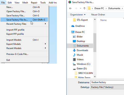

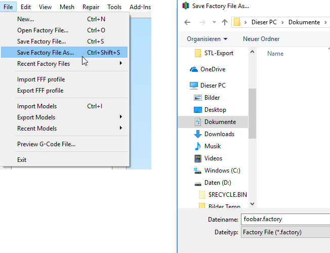

phil123456 wrote:there is no choice wwhen I do an export, it's just an XML, nothing easier to read in the universe :-)
Ahh Ok, you exported the FFF. Anyway it it easyer to let us chose what editor we use to read, so we don't have to search on a 50cm long page...
The factory file is more like just a xml.... in a factory file everthing, including the model is inside. Then upload via "Upload attachment"
