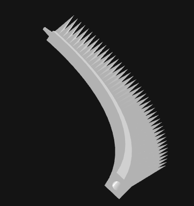

I've just started using Creator with my new M2. So far I'm concerned. Here are the problems I've encountered so far:
1. Some models are just incorrectly rendered.
2. The arrange feature doesn't nest correctly. I can manually drag parts into position, but the arrange button should position parts to use space efficiently and ensure that non-oversized parts are placed inside the printer's platen constraints.
#1 is the most concerning, obviously. I at first worried that the problem was the nut behind the bolt (e.g. me!). However checking the model in multiple other programs shows that the STL file renders correctly in every program other than Creator. I will conduct a test print in slic3r and Creator today to see if this error is merely visual rather than structural, but either way it seems to indicate a problem.Here's a screenshot of the part from Pleasant3D:
Part Screenshot from Pleasant3D
Screen Shot 2013-04-02 at 1.23.19 PM.png (21.93 KiB) Viewed 8730 times
I've also attached a copy of the STL file for you to examine in Creator. The issue is the small tapered cylinder on the end of the quarter circle. It's not rendering at all in Creator.

Greybear,
I made an administrative change on our end, so you should be able to attach your .stl file now. If not, you can always zip it and then attach it after that. It's going to be hard to help much without getting to see the actual file in question. I have a few ideas, but it will be easier if we can look at the same model.
Concerning the auto-arrange feature, we're using a square footprint for each part right now for performance reasons. The part you posted looks like a banana so it's not too surprising that it doesn't compute the most optimal packing arrangement. We've tried to do a complete 3D surface bounded packing scheme in the past, but it takes orders of magnitude longer and can still fail in many scenarios. If you have a particularly oddly shaped part, yes, it will probably require a bit of manual placement. Thankfully there's easy mouse and keyboard shortcuts so that it's pretty easy to do.

So after looking at your STL file I found the problem pretty quickly. This particular STL file is actually 2 individual STL files spliced together. If you look at line 10908, you will see the standard "endsolid" tag that typically defines the end of the model. However, in this case, there is another model spliced to the end of it. This is pretty unorthodox and goes against typical file format standards, which is why Creator isn't importing past the first "endsolid" tag. We might try to play nice with these odd files in the future, but for now, just remove lines 10908 and 10909 from your file and it will load with no issues.
